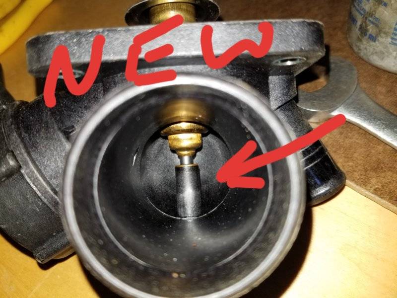

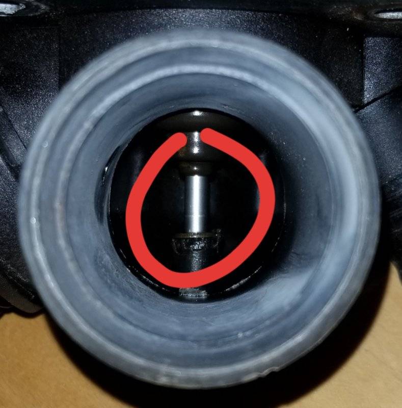

Replace the thermostat housing. See the pics of a failed part with 78K miles off my 2006. You can see the collapsed boss in the red circle that the thermostat pushes against. The thermostat will never fully open and the car will overheat. Get Motorcraft parts and change the thermostat while you're in there.

Replace the thermostat housing. See the pics of a failed part with 78K miles off my 2006. You can see the collapsed boss in the red circle that the thermostat pushes against. The thermostat will never fully open and the car will overheat. Get Motorcraft parts and change the thermostat while you're in there....
Again, replace it all, not just one or two parts. Once and done!

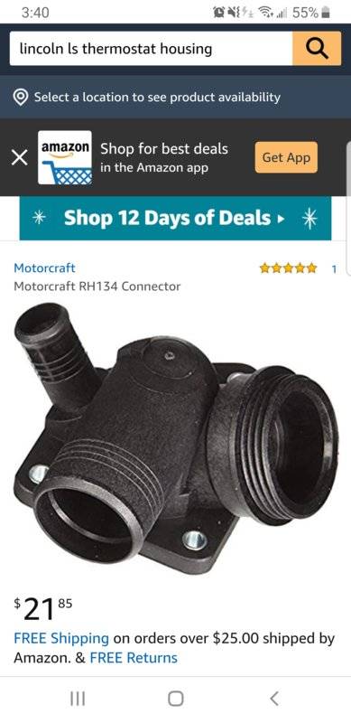

You can buy the whole schabang at Amazon for $42.61 and DIY in 3 hours.
