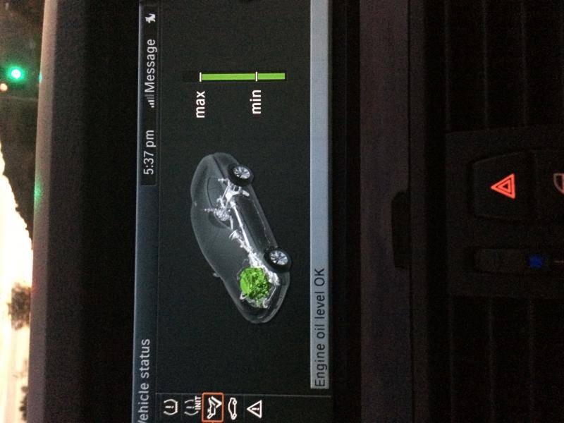

I have one of those..... Here's how I check the oil level...
I still prefer a dipstick to anything else, but that electric display is better than what the LS has for checking the transmission level, which is CLIMBING UNDER THE FRIGGIN CAR! That will NEVER be OK to me. At least with the electric display you can check the fluid without having to climb into your greaser clothes and spend half an hour getting the car in position.
