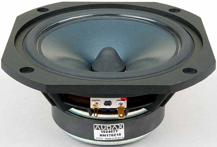

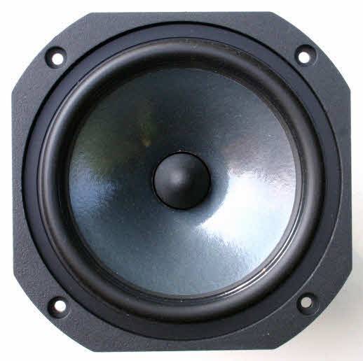

Audax AeroGel with Phase plug. The AeroGel is patented by Audax (Made in France). Tiny woven little fibers, and then coated on the surface. But when you flip the driver upside down and look at the fibers, its amazing. These speakers will bring VOCALS to life!!!!!! I couldn't believe it myself. I run them in my home theater, and soon in my 05's front doors.
I Tested them against Seas drivers, Dynaudio, and several Kevlar Drivers. Of all of them, the Aero Gels truly brought Michael Buble (what I was playing to test) to life.
How I tested was in two towers, I equipped one with a different brand Driver, the other with Aero Gel. And swap out to compare. Had people sit back and close their eyes and I would A/B them with the drivers. My wife (among the tester subjects) actually jumped when I powered the Tower with Aero Gels. She said she thought Michael Buble was in the Room singing. LOLZ!!!!

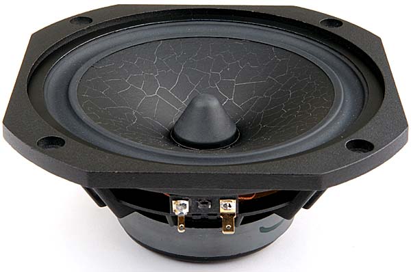

These ones are a Limited made, for Mission when Audax was owned by the Harem Corporation (not anymore now they are private invested). Mission Launched a high end, and used Audax and had them do a cracked effect to the clear coat, and an inverted surround:
To be honest, I haven't a Clue. The drivers don't come with crossovers when you buy them as individual speakers.

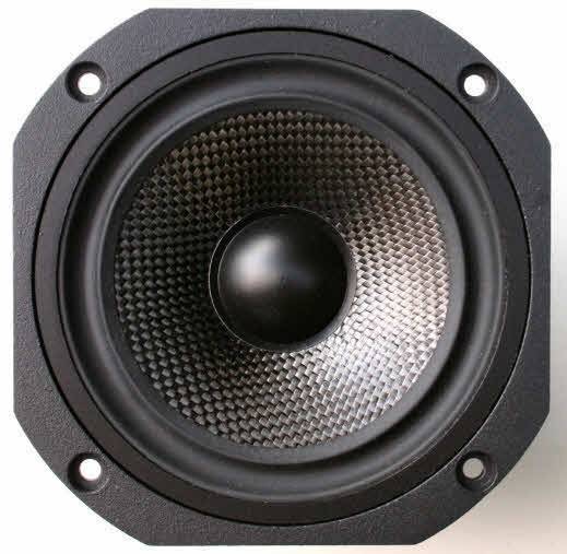

Seas 27TDC Tweeter on top, Audax Aero Gel 6.5 in the middle, and an Audax Carbon Fiber 6.5 for Low Mid response on the bottom, each speaker crossed over per intended.
You setup would like like:
In my opinion, that ^ Setup, would easily sound better than most Klipsch, Boston Acoustics, And even lower end Dynaudio setups. And you would pay a fraction of what those companies charge, that is if you can build your own speaker box and solder crossovers on.
