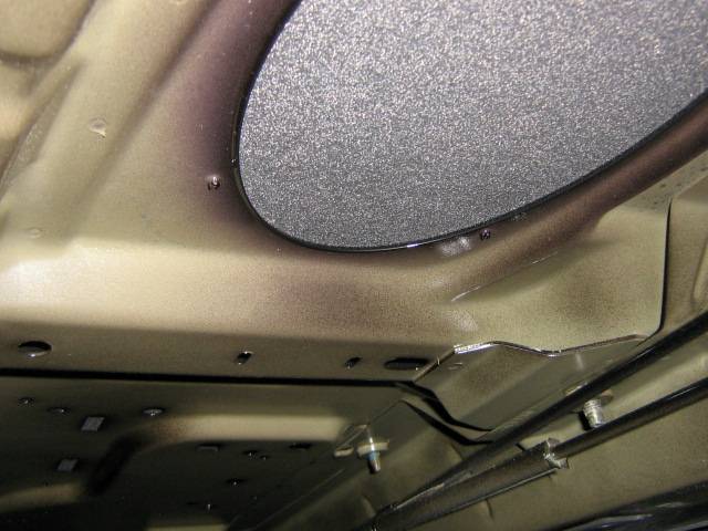

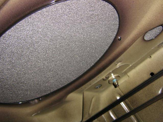

i just checked and i have the cut outs for 6 9s i just need to run wires

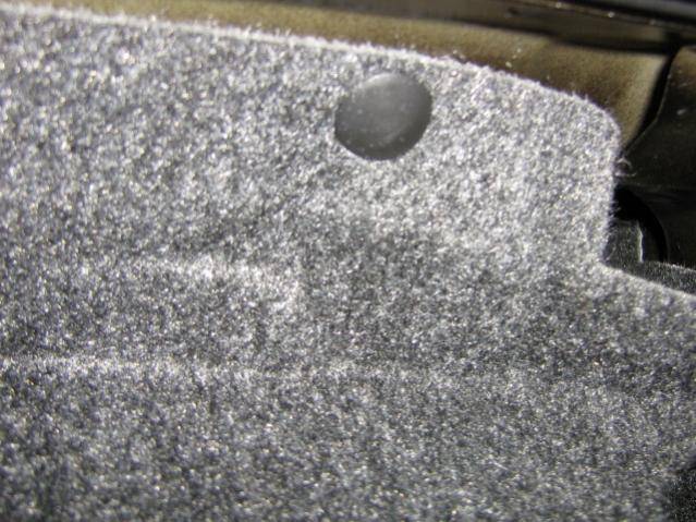

how can i get this clip off without breaking it?
This
http://www.harborfreight.com/5-piece-auto-trim-and-molding-tool-set-67021.html
or this
http://www.amazon.com/CRL-Clip-Zip-...51456388&sr=1-7&keywords=plastic+clip+remover
Don't worry about it too much. You can get replacements at just about any auto or hardware store. (You really aren't supposed to reuse them anyway.)

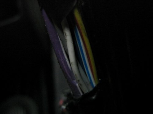

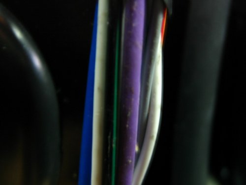

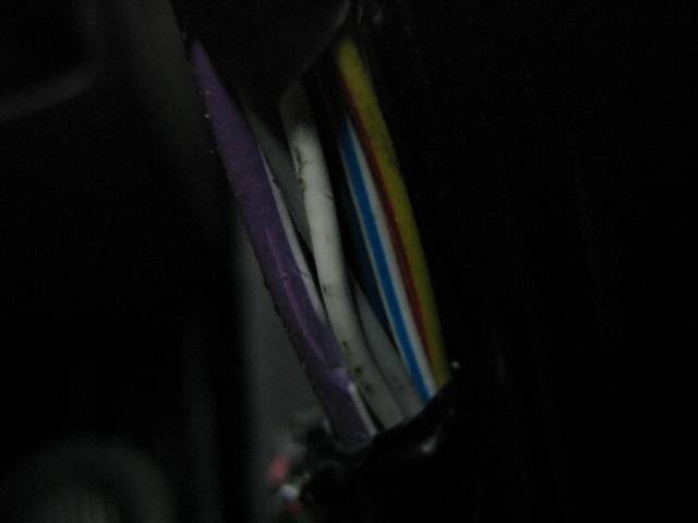

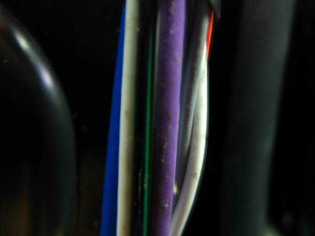

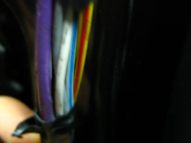

all wires are color coded which colors are the speaker wires?
which are the speaker wires for the rear door speaker
Should be white/violet and gray/white for the left. White and Gray (both solid) for the right.
2004 Lincoln LS Car Stereo Wiring Diagram
Car Radio Battery Constant 12v+ Wire: Orange/Black
Car Radio Accessory Switched 12v+ Wire: Yellow/Green
Car Radio Ground Wire: Black/Green
Car Radio Illumination Wire: N/A
Car Stereo Dimmer Wire: N/A
Car Stereo Antenna Trigger Wire: Yellow/Red
Car Stereo Amp Trigger Wire: N/A
Car Stereo Amplifier Location: N/A
Car Audio Front Speakers Size: N/A
Car Audio Front Speakers Location: N/A
Left Front Speaker Positive Wire (+): White/Black
Left Front Speaker Negative Wire (-): Gray/Black
Right Front Speaker Positive Wire (+): White/Red
Right Front Speaker Negative Wire (-): Gray/Red
Car Audio Rear Speakers Size: N/A
Car Audio Rear Speakers Location: N/A
Left Rear Speaker Positive Wire (+): White/Violet
Left Rear Speaker Negative Wire (-): Gray/White
Right Rear Speaker Positive Wire (+): White
Right Rear Speaker Negative Wire (-): Gray

the speakers wont fit in the speaker cut outs the black rubber parts of the speaker touch the metal frame the speaker gets choked...what to do start filing?
on second thought i'm just gonna get longer scews the speaker will hang a few MMs but that's ok I will duck tape around it
Ok if you have one of those flat mount T.V. wall mounts kicking around in a box?
Inside they provide some spacers, used to keep the mount off the wall but to screw through. you can use those spacers to keep the driver off the metal frame, yet have it secured and tightened.
Essentially, anything dowel shaped with a whole in the middle would be ideal here. Try looking around the garage? around the house? old drawers in cabinets .. you never know what you find. Be creative.

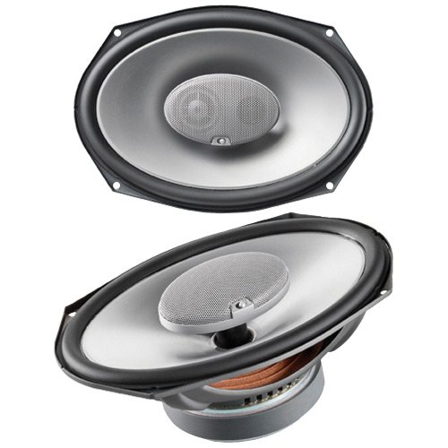

I used three 3 nuts on each screw between the speaker and the frame fitted perfect no need for duct tape sounds awesome six speakers is much better then four sounds like I have a surround sound system/ home theater system in my car
the speakers I used the sound from these speakers are very clear/bright like most infinity speakers
