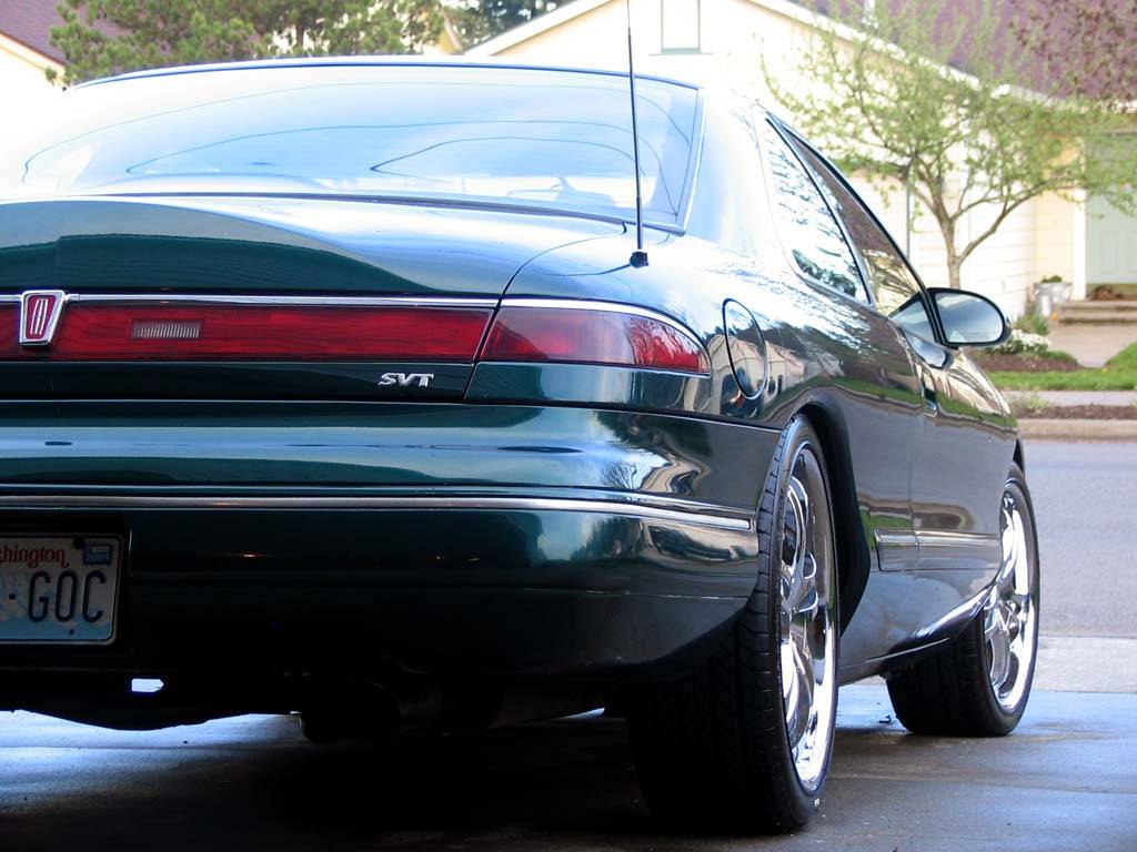

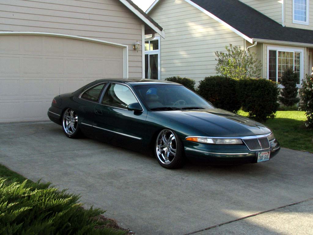

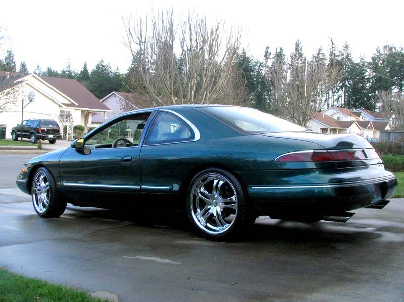

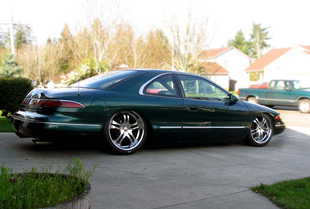

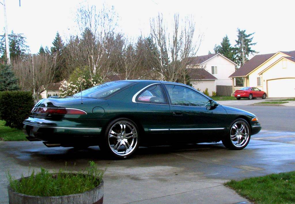

Nice... 20's look wild on the Mark. Any issues with rubbing? Also, is that the stock air-sus lowered like that?
The car is fast bagged through modified stock bags. I added some air suspension info in the description section. It will rub when totally aired out, but the car can not be driven at that height.
Very nicd DJ. Those 20' Capones are killer. I see that the 245's barely made inside the well. What was the offset on those rims. A dropped Mark with big rims is the look for sure.
I've dreamed about "Pimp My Ride" knocking on my door and pimping mine like that, I'd lick their garage clean (exaggeration? not!). My friends think I am crazy cause repair $'s hurt, but she is so worth it. Nice to see I am not alone, yours is beautiful
one day ,one day my mark will be like that, im really feelin urs bro...!!
3-8`S IN KANSAS,CITY-ROLLIN 20`S,NONE BLACK,BAD ASS
That's sick. Soon as I graduate and start gettin serious money, I'll be going on a modding spree.
Hey dj I just bought a 1996 mark viii. Can I run 20 inch rims without modifying the bags?W/ the same offset?
press77 - You do not need to modify your bags, 245/40/20s fit fine with 3/16" spacers up front. You could run 245/35/20s without spacers.

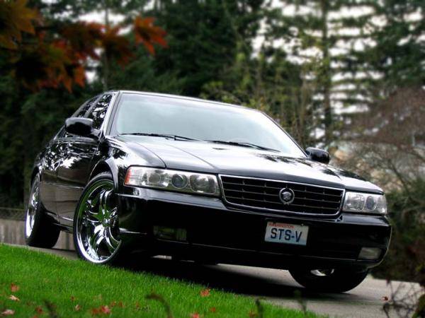

Man, that Mark is sweeeet! But the edited pic of the Cadi is really not cool. I saw that grill and damn near lost mind! I've been trying to find a V grill for my 98 STS, an I thought I finally found someone who could tell me where to get it.
hey dj this maybe a stupid question, but does the spacer go between the shock in the bottom of the shock tower and where can you order or buy them from?
