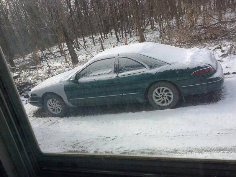

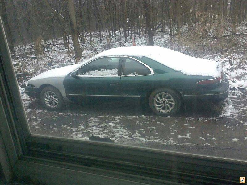

young mark 8s progress thread
the hardware was toast the bolts snapped and my idiotic friend threw out the shims when i had it off but it lines up perfectly without them and am i able to use the rear shocks for a 94 tbird v8 on a mark?
yours may be dirty and need body work but atleast its 95% one color. mine is 6 different colors but lol
shims? ive pulled a total of 6 gen 1 fenders and never seen any. i've got plenty of leftover fender bolt you can have if you pay shipping. shoot me a pm and we can talk fenders and see if u like what i would charge you

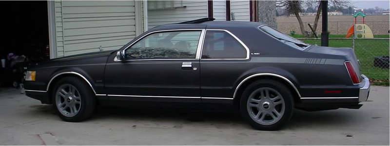

Holy scatter brain..marks in flat black would look stupid
Not all Marks! I know its a VII but it is a Mark! ;)
