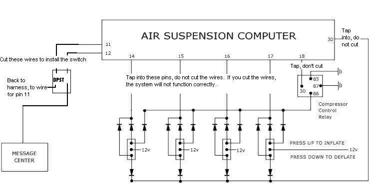

are you marketing the lowering switches again..or is it on hold still......could you make it a two switch kit..i would like to have it where i could lower the front and ten the rear...if not thats cool.....i saw a ford falcon yesterday @ HUMPERDINKS LAYING FRAME
If your good with electronics, and reading schematics, then take a look at this. It can easily be modified to run a 2 switch system.
I have this in the 95' and will be going in the 98 when it gets "home"

They are still on hold, but will be back going soon.....I have a few ppl on the 'waiting list' for the kits. I can wire it up just the way you want it.....no problem......
