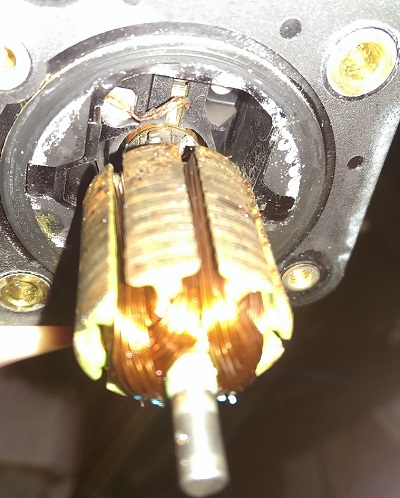

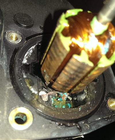

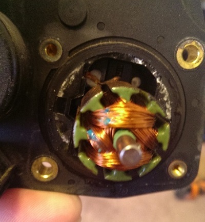

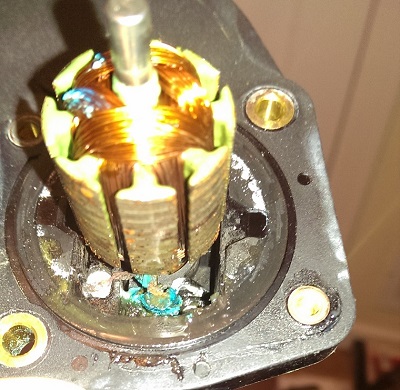

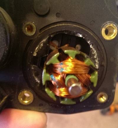

Me being the curious type I decided to dissect the old motor to find the point of failure. After taking the metal exterior motor cover off I found a brushed motor and the failure was pretty obvious. Moisture got in to the motor and due to the angle of how the assembly mounts it pooled on the bottom brush. It destroyed the lead going to the bottom brush and had started eating at the motor windings. The other brush at the top was not corroded, but the brush spring was pretty rusty and the brush was not very free moving at all. I will attach pictures to show the damage.
