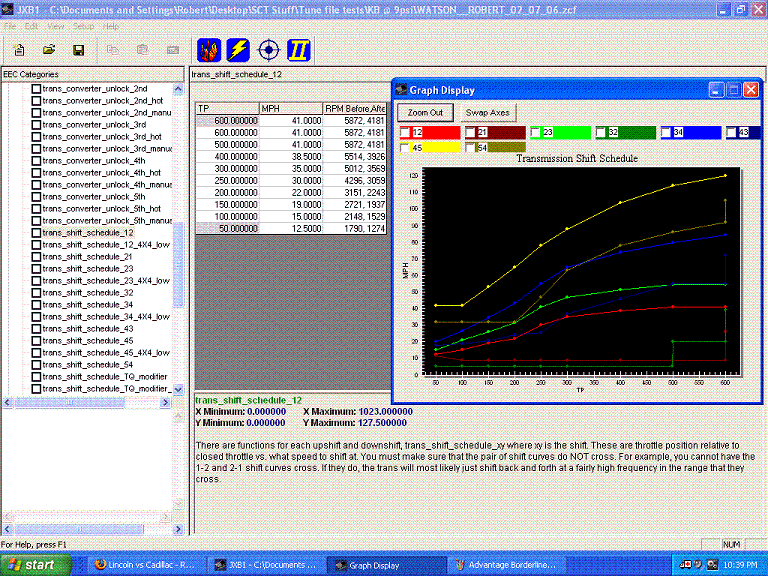

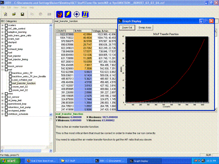

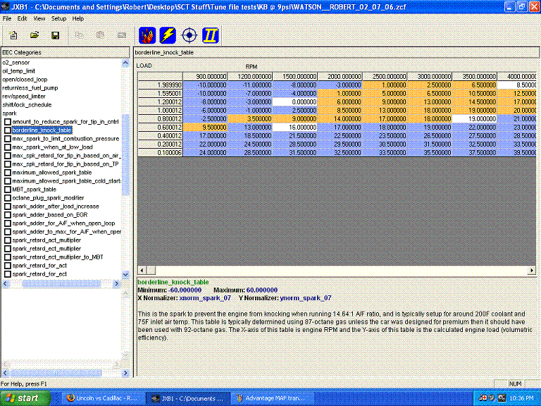

Here are some screenshots I just made for you, Stinkin. There are a lot of specifics to tuning and I dont really expect you to understand this. But if you did, then THIS is some of the things that are modified to produce more power, better shifting, adjust A/F trims so on so forth. There are many other perameters involved, but I picked a select few for people to see for example purposes.
