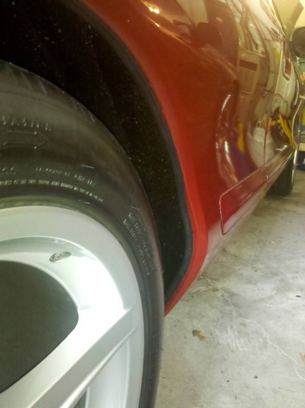

So I am going to have to roll my rear quarters, since my 285's are rubbing. The roads around here are...crappy to say the least. So I need to act fairly quick, before the quarters eats away my new tires.Looked into renting one, but think I am just going to buy a good quality one.

As far as trim vs roll. I only have a slight rub on the outer edge of the sidewall. So I only need a little more clearance. Not concerned about maximum clearance. If it gets to the point I need more than a 285, I will just get DR's. :D
I might however, go check out the quarter panels later, and see what all cutting would be required. Not totally against looking at all options...I'm just progressive like that. :p
