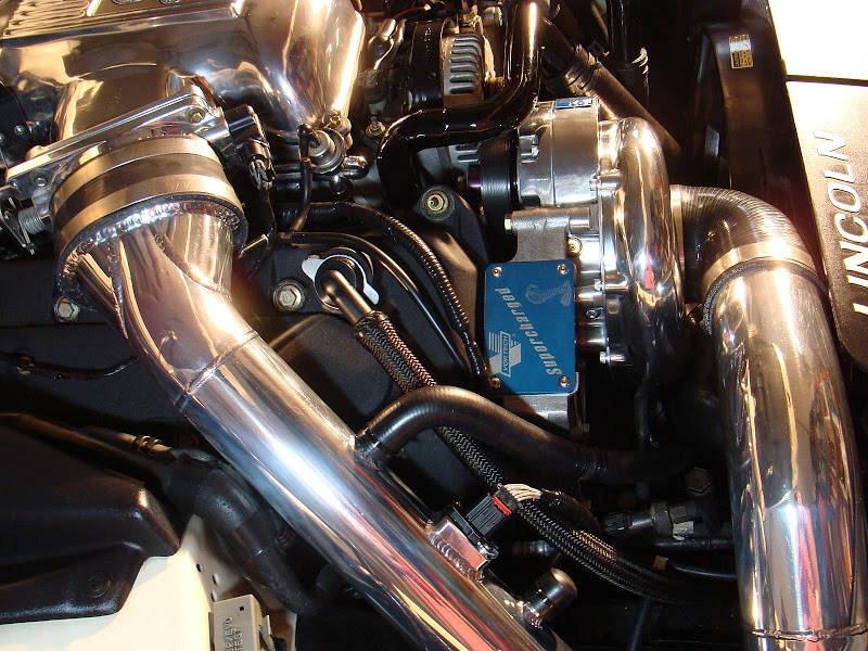

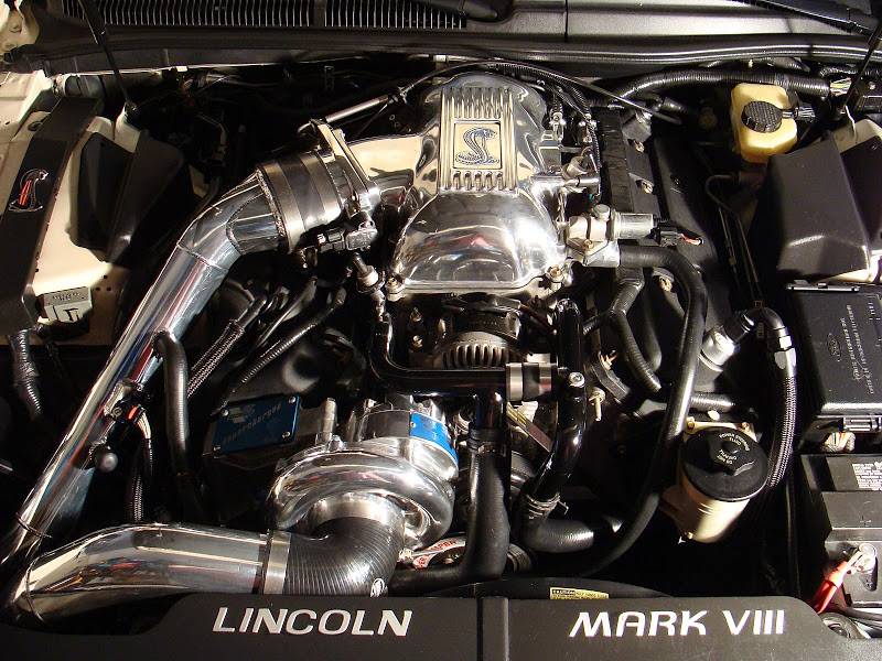

I can say with out a doubt in my mind that when you run high boost, a catch can is a must. I have a line running from both cam covers into a vented breather filter style catch can that is buried in the drivers side fender.
Bye bye oil spray and foul combustion odors. :) Cam cover mounted breather filter had oil going all over the place and stunk up the cabin. IMHO, Catch can breather buried in the fender is the only real fix.
So your running no pcv back to the intake. Just a can with vents. I like that Idea. I haven't had any issues with the breathers spraying oil around yet but when the boost goes on I'll need the cans. Are you using a check valve for the vac lines to the hvac system?

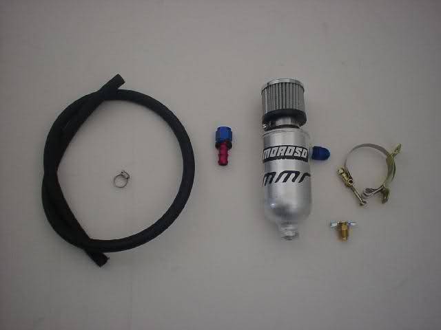

Don't just get a regular catch can. These are pricey because you can make your own but if you are boosting use something that is proven to work right.
I think all I have left for pollution control are two magnaflow cats and ford o2 sensors. Everything else is long gone.

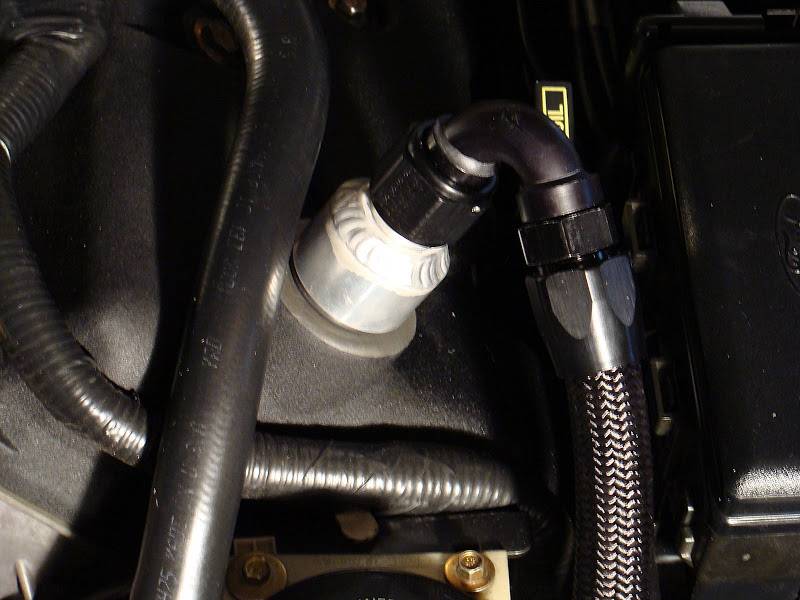

The IAC recycles air to the metered side of the intake tube. All crankcase air vents to atmosphere through the catch can vent, and the blower vents to two blow off valves on either side of the intercooler. No crankcase air is recycled back into the blower.
My catch can is similar to the moroso one. A real nice looking billet piece with a petcock valve. Parts and labor, I think I have about $500 in the complete catch can system. Well worth it not to smell, or see spent oil. :) You can see the PCV plugged off if you look close in the picture.
