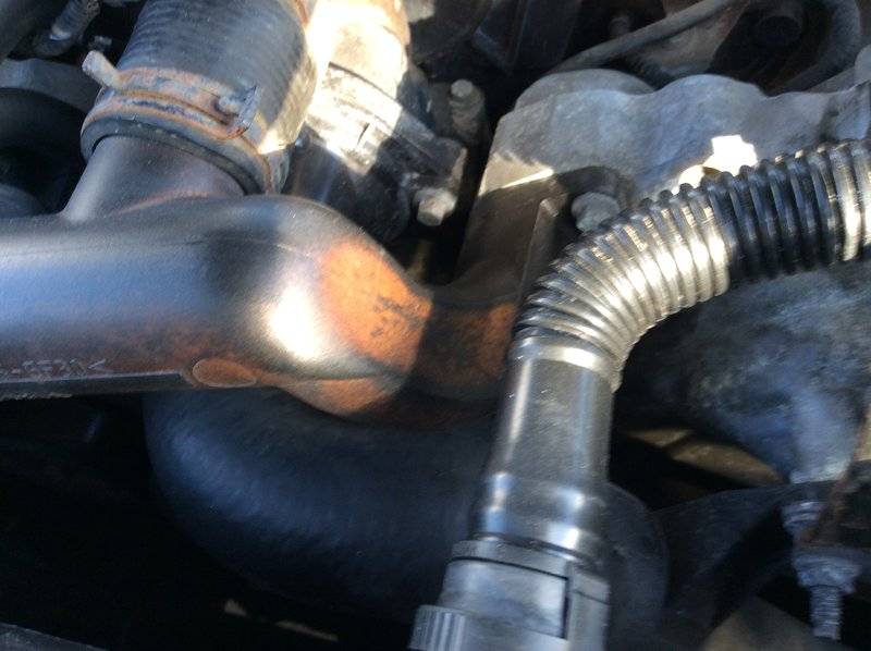

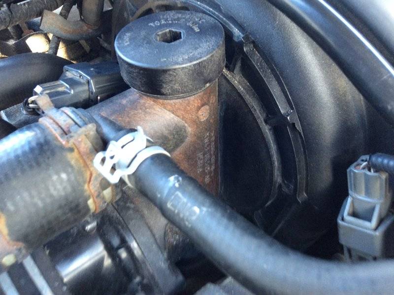

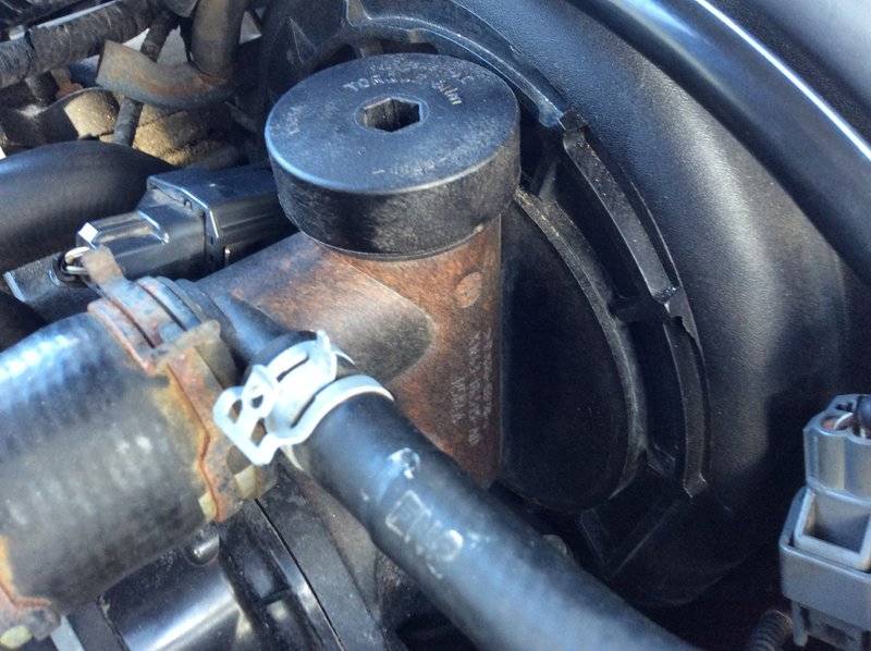

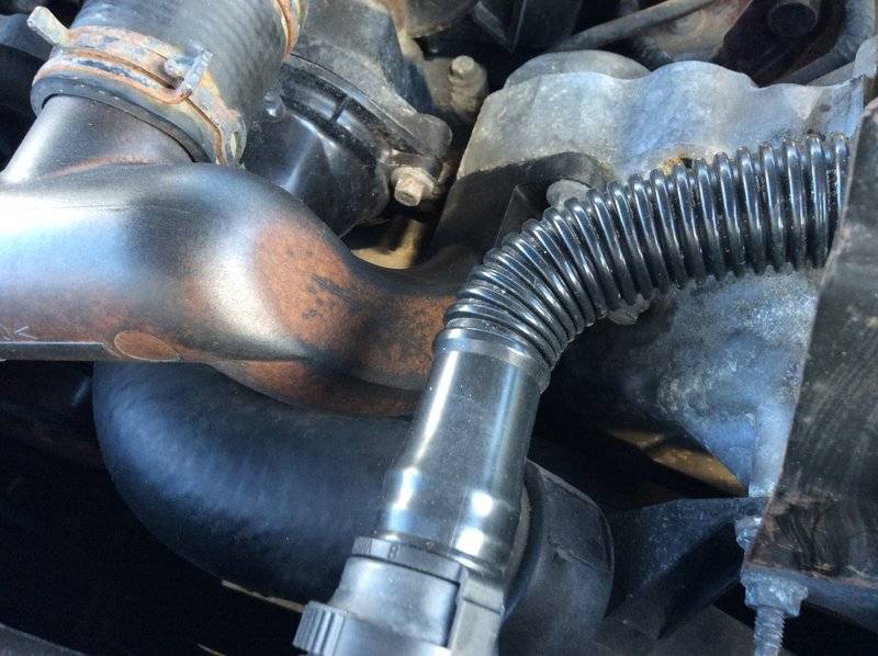

    I saw some wore out plastic coolant parts in a pictur that Rigs posted on a thread. The plastic was brownish in color instead of black and I'm wondering if this is the sign of coolant parts on there way out? I'm curious because the plastic by my engine fill cap is now brown and it used to be black I don't have any leakage as of yet but knowing that my 2001 Lincoln LS V8 has 170,000 miles and maybe more It's only a matter of time before I will be replacing the plastic parts...by the way I want to use the Jaguar parts that I hear are aluminum if anyone can point me to a thread that has the part #'s for these compatible pieces I would greatly appreciate and forever be grateful...Thanks

    Yes, brown is bad, but be aware that many (most?) fail before they ever turn brown on the outside.
    White or orange residue is another sign that they are already leaking.
    There is a recent thread on the main forum with many of the gen I cooling part numbers for the V8s.

    So is it possible to say Joe how long before these plastic parts start to fail after turning this brown color? Do you know a ball park figure how much it cost to replace the entire cooling system either plastic or Jag aluminum parts?

    That browning haze on the exterior of your cooling system parts is a very good indicator it's all pitted and rotten on the inside. Just looking at it I can tell it's a matter of any day/week now. They are old, brittle and it's deteriorating. That will not last into the winter. Roughly +/- 800$ in parts, which would include a new degas bottle. I'd recommend doing the DCCV and Auxiliary Coolant Flow Pump at the same time while you have the system open, depleted of coolant and lines off.
    ~ The plastic cooling system deteriorating process does not make appointments.

      They started failing before they got this bad. A big or complete failure could be any minute now. Gen II is in the $500 range. I think gen I is a little less.
