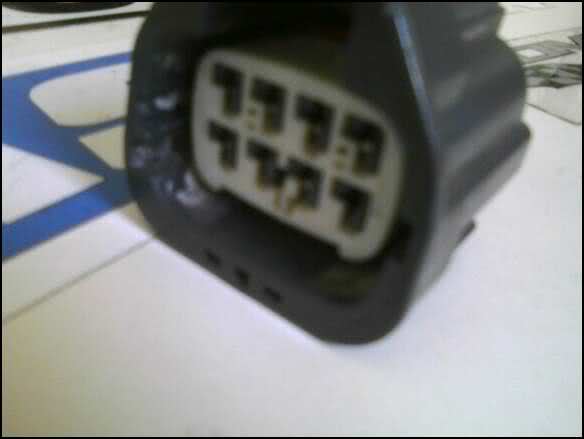

here is the connector I'm working with. I've shaved down a windshield wiper blade to try and pop the pins out with no luck.
anybody know how to get the pins out of the connector?

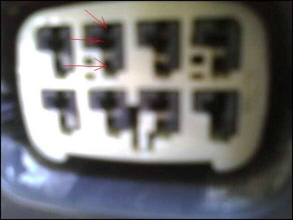

here is as good as a pic as my phone will provide, the red arrows point to the holes.
there are tools that can be bought/made for certain types of connectors I've found, but for this specific one the trick is to actually pull out the white face piece you see in the pic, this allows easy access to unlock the pins. at this point you can simply use the end of a test light or something pointy.
some connectors have a locking clip you can see that removes the housing but this one didn't, just gotta pull the sucker off.
