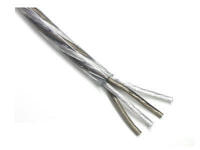

This is 12ga. bi-speaker wire by Knukoncepz. It's two sets of 12ga wire twisted into a solid jacket. Each run will potentially be carrying 125 Watts to each of the two drivers in each door. I just need to get this ~1/2" Dia. cable through to the door on each side, then I can split the jacket to send the leads to the mids and the tweets.
this is where your gonna run into problems, if that wire really is .5" OD, I dont know if there is going to be enough room in the boot with all the OEM wires in there, they are not that big to begin with. i didnt really have much trouble pulling a 12awg set through with thick insulation, it made it a lot tougher to pull another three 18awg singles in for the alarm.

That is the exact wire I used..
I did NOT drill any holes in the door or jam.. I ran thru the factory boot.
BUT.. I did not want to touch the PCM so I went thru the metal in front of the PCM and then thru the boot.
Then to get thru the boot I had to pull the doorpanel (obviously) and cut lose the tape that attaches the boot to the wires so you can slide it out of the door. Pretty standard procedure and my hands hurt for days after all 4 doors
