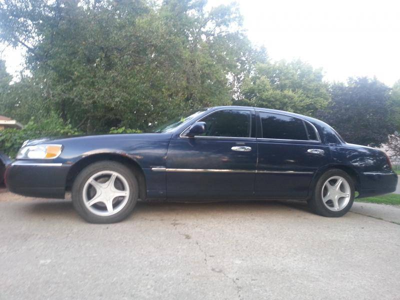

I have 17's on my 01 with a 235/55 R17 tire. The car can handle turns allot better now.

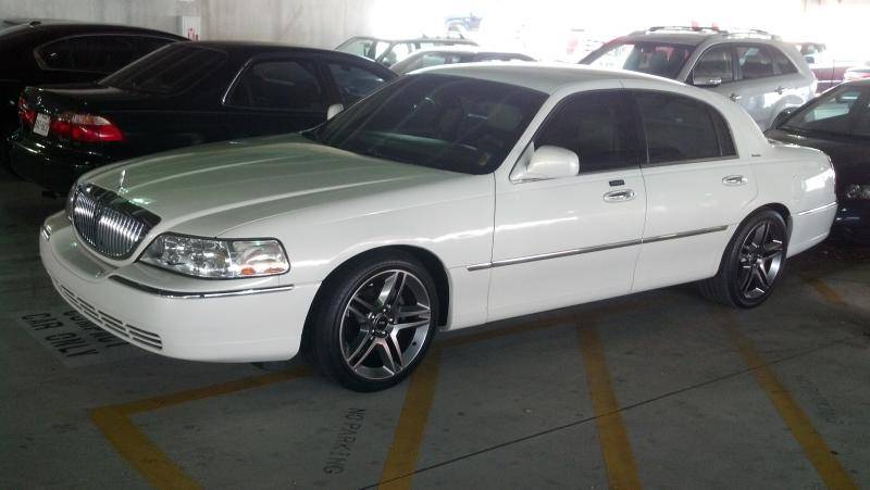

Looks good. :)
But the 285/35/19s are a lot smaller than the OP of 275/45/20!
