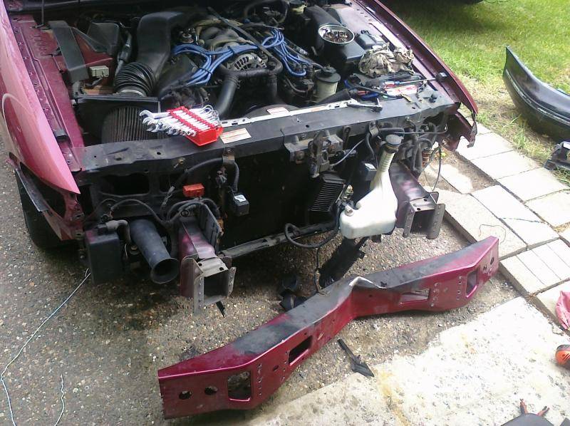

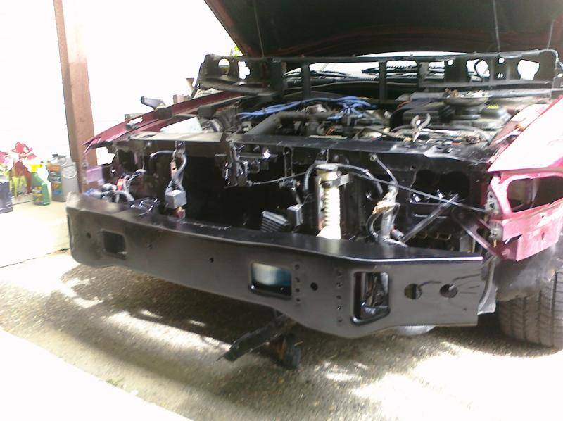

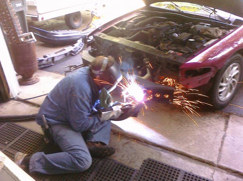

I had to rebuild my front end after my crash and it has been doing it since.
Also the air bags did not go off.
