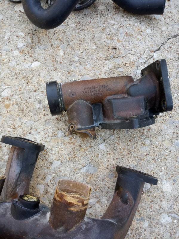

I believe ive fixed it! When i pulled the old flange off, the ends where the hose slips on, had the consistency of cardboard. And the same with the thermostat housing. Wow.. Why would they even put that material on a cooling system?
The remaining plastic parts are the same way. You'll be back very soon if they weren't all replaced.

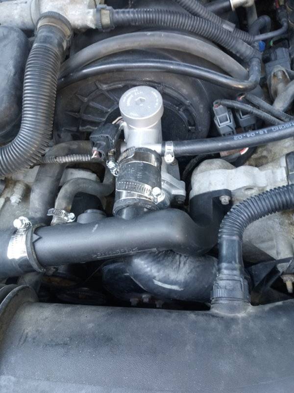

What ya think?
I got it off without pulling the intake too. Used a wrachet wrench with an elbow.
You didn't mention the cross over, but I see you did do that. You are missing the upper and lower radiator hoses, both have plastic sections.

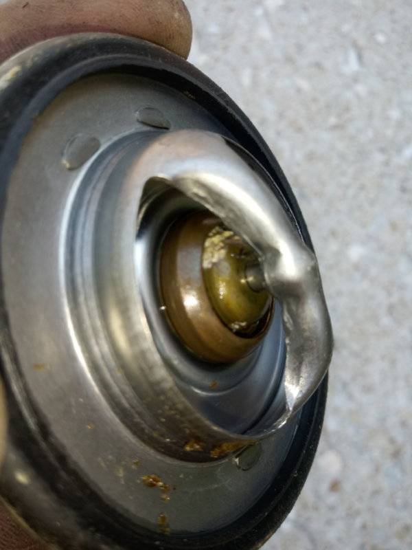

This is the thermostat i paid a shop over a hundred bucks to put in 6 months ago. I think i got ripped off.

Yes, ripped on the thermostat.
