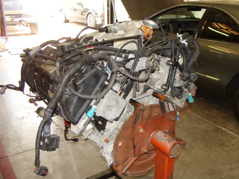

I'm just curious why anyone doesn't upgrade the flexplate in our car? I'm not an expert in auto's by any means, but doesn't a flexplate work the same way as a flywheel would in a manual car? If so why don't we opt for lightweight versions to increase acceleration?
In case I have the wrong term, here is a pic of what I'm talking about. I'm referring to the big rusty wheel on the back of the motor.

there is no upgrade for a flexplate. The flexplate is there just for the starter to be able to turn the engine.(flexplate doesent weigh much) Now a flywheel would take the place of a torque converter in an automatic car. A(n) upgraded flywheel is usually stronger and can be made lighter. I believe lighter would make the engine rev a bit faster(accelerate a bit faster)
It's all related to mass and there's a difference between a flexplate and a flywheel. Flexplates are designed to allow the starter to start the engine and provide an attachment point for the torque converter. Want a quicker acceleration rate? Use a smaller diameter torque converter (smaller diameter=less fluid and other rotating mass to rotate=quicker engine acceleration). The torque converter makes up the rotational mass difference. With a flywheel, it is designed to have more rotating mass so that the engine will run smoothly while running and while the clutch is being engaged. Yes you can get a lighter flywheel and get faster engine acceleration, but the engine may run "rough" because there isn't enough mass in the lightened flywheel to dampen the power strokes of the engine. I hope this helps out
