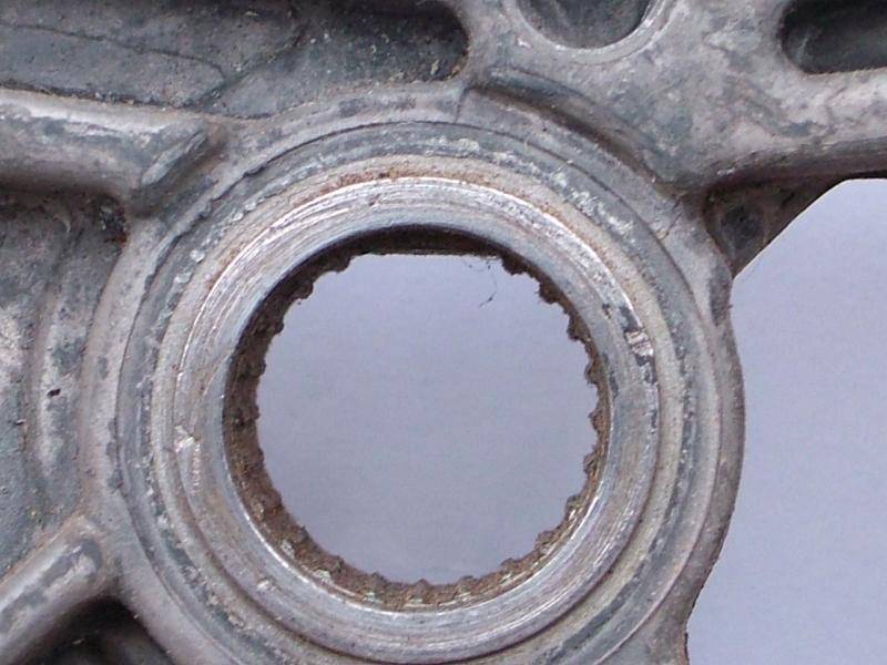

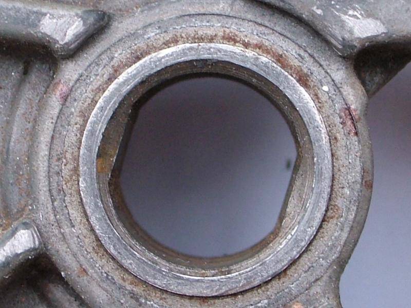

Steering shaft
Steering shaft changed from flats to splines in 97-98 and 93-96

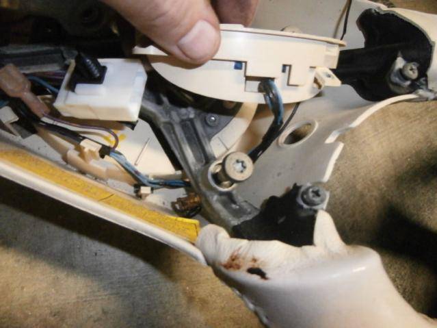

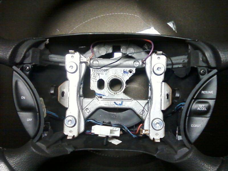

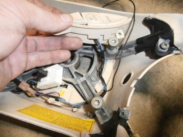

the wiring is different so I will use my buttons and horn activator from the Mark and put in the Mustang wheel; need to pull the wires under the frame- how can I open up the buttons and disconnect the wires?
That trim piece on the back of the center part of the wheel comes off. I think it's held on by screws. You don't need to disconnect the wires from the buttons.
conversion completed; I had to open both pairs of buttons, take the PCB's out of the Mark button housings and put em in the Mustang (black) housings, Mark PCB's = 5 wires each with light, Mustang's are 2 each with no light, button housings and covers are the same; also used the horn/spring bars from the Mark. painting the Mark air bag and hopefully it's a tight fit!

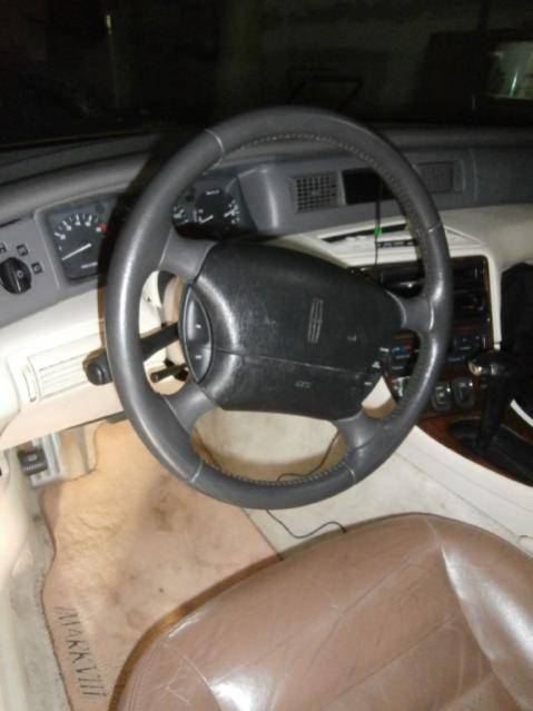

Mustang wheel installed (charcoal colored) with black air bag...big improvement! the color contrast is amplified by the flash
