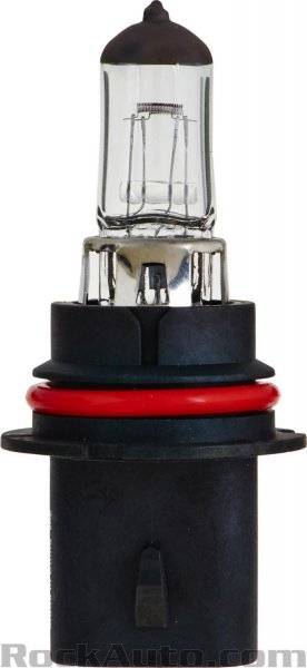

    If you are referring to our Lincoln Mark VIIs produced from 1984 to 1992, they left the factory with series 9004 halogen bulbs.
    They are readily available over the counter from your local AdvanceNapaO'rielyZone.
