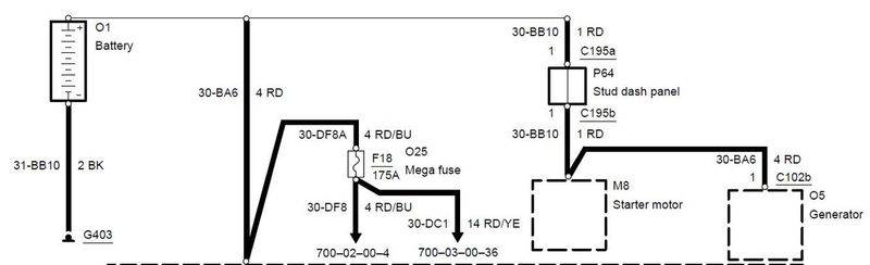

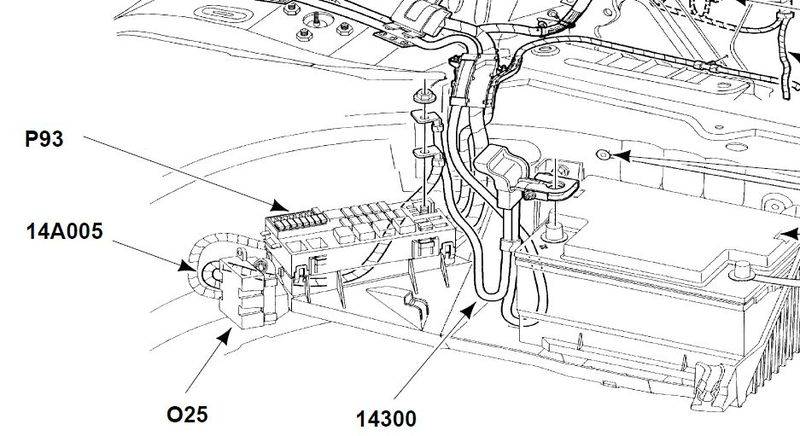

Yeah it is, by the mega fuse in the trunk. That posts runs directly from the battery after the fuse down the passenger side.
I have a diagram here somewhere.
EDIT ....

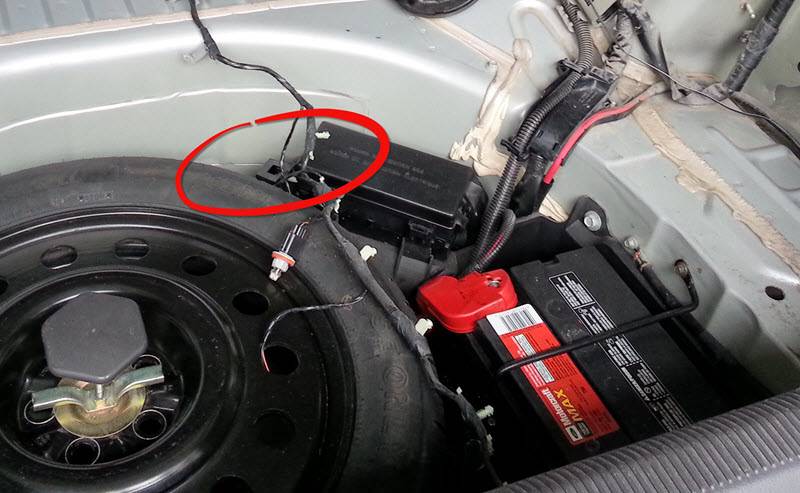

Pardon my trunk lid light wiring laying across it.
O25 = Mega Fuse / 175A
...the purpose of is to give emergency power to accessories in case of a dead battery...
The purpose of it is simply to pass a high current battery connection from the battery in the trunk, though the firewall, to the starter and the alternator. It's also a junction where power for the electric fan is tapped. Some other cars with batteries in the trunk (like BMW) do provide a convenient jump start terminal under the hood. This junction was never intended for this purpose.
