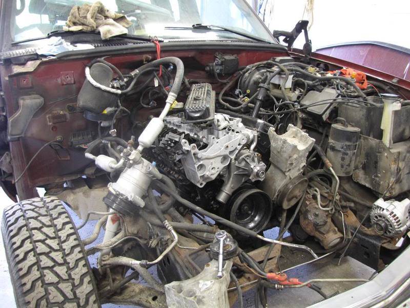

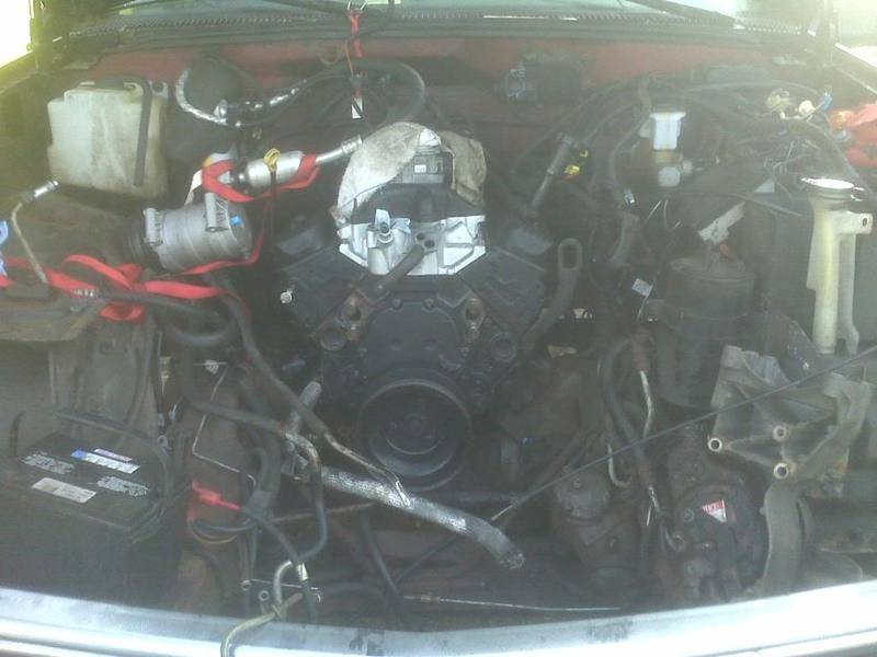

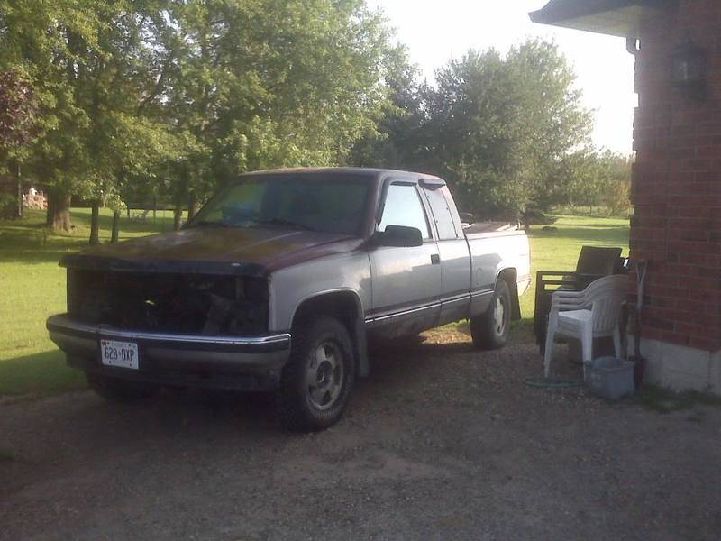

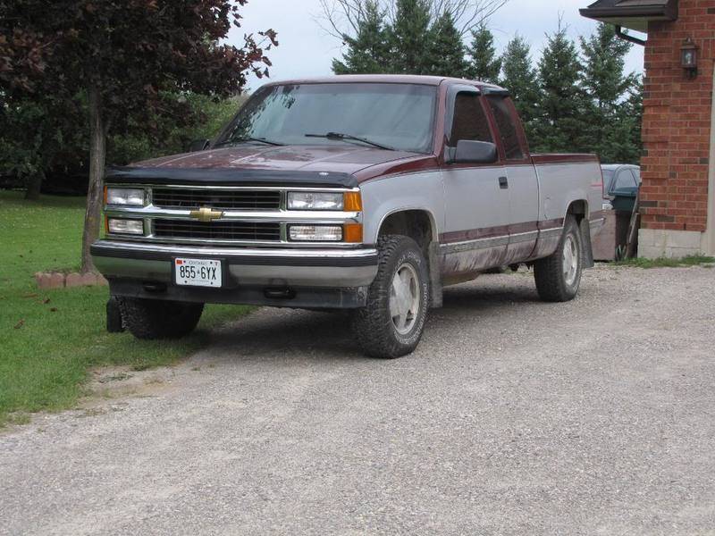

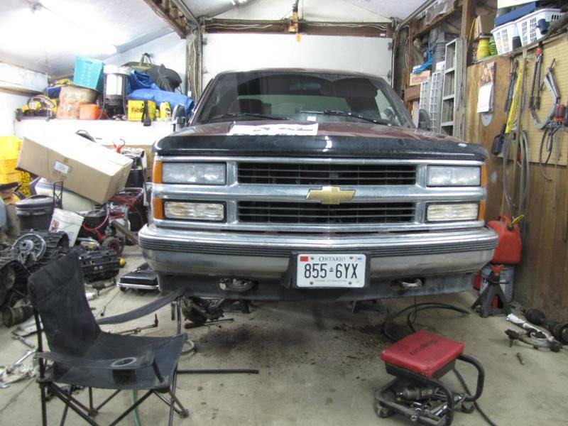

ok pics pretty much how it came home. I put the hood on to keep water out as well as put rags in the intake and such to keep critters out. But no work has been done to the truck in these pics.
motor is freshly rebuilt and isnt even back together yet
body is dirty (sitting in a warehouse for a few months) but is freshly redone as is the lower paint

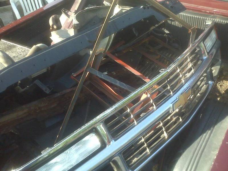

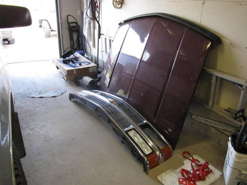

bed is full of parts to include new rad support and grill

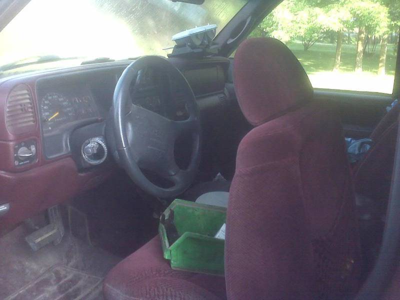

horrible shot of the interior, but you can see the captains chairs.... this thing is fully loaded and everything works. with roughly 300,000 miles on the interior there are a couple wear marks but no rips or tears anywhere.

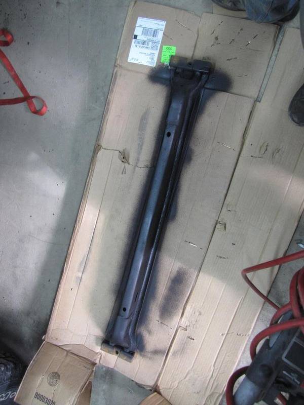

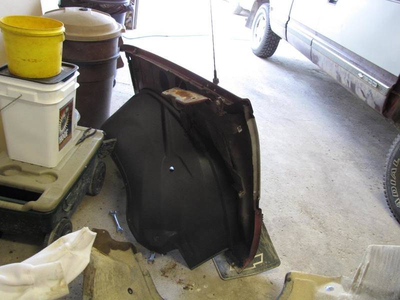

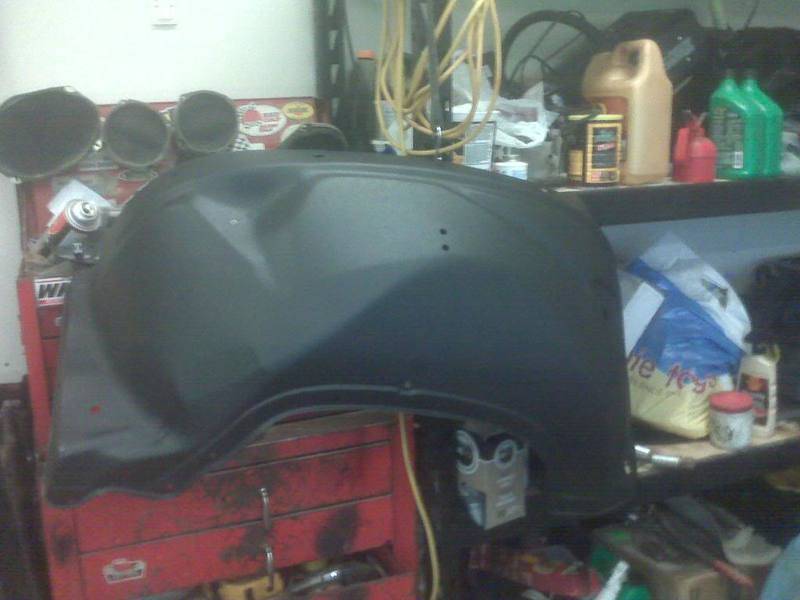

the passenger side inner fender is the only rust spot on the body. So I bought a new one already in primer, so i scuffed it and coated it in rocker guard. While everything is out of the engine bay and the rad support is out, now is the time to do this, even though I could get away with closing my eyes to it and just slapping everything together. I've got almost triple my money's worth with buying this truck vs others on the market so I cant imagine half assing the re-assembly.

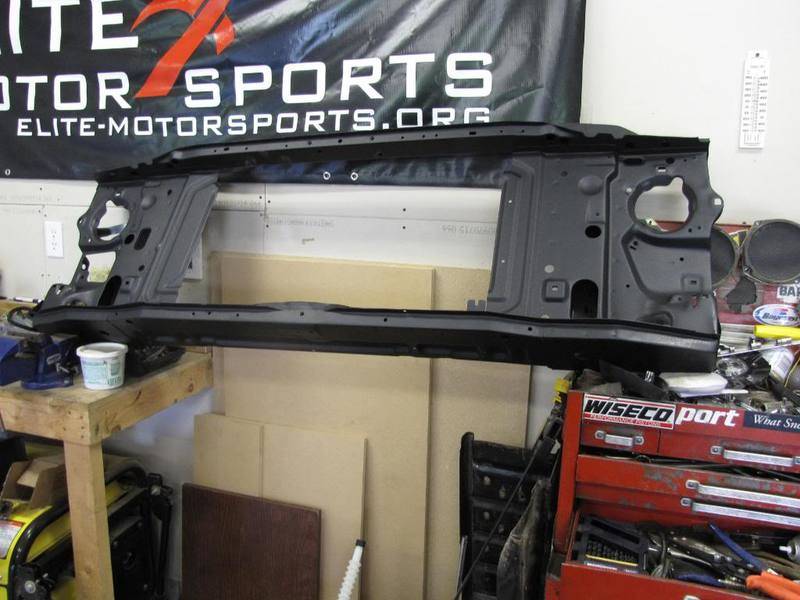

with progress comes pics I got the inner fender painted and swapped, painted the new rad support and hood latch support as well as spray bombed the batery bracket thing just to clean it up. I also through the water pump and distributor in place as well as the fuel injector spider thing. Nothing is tight yet since Im not 100% where each bolt and bracket goes. Im mocking it up now and then will go through and do it right when I know everything is where it belongs. My headers, cats and mufflers should be in today as well

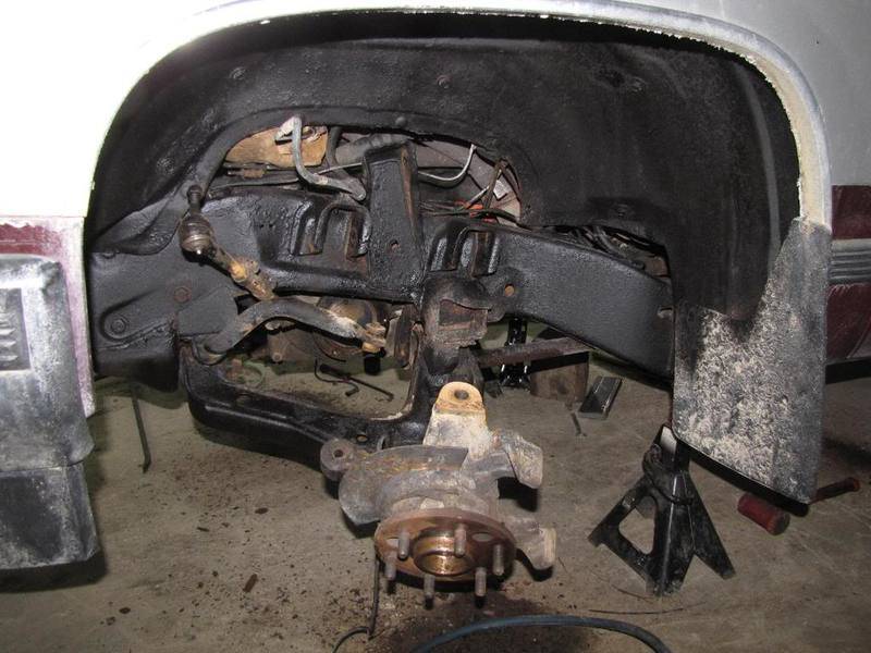

I've nick named this "project hack job" based off the condition I got the truck in. The brake lines had rotted out so the ran new ones..... anywhere they wanted. They didnt even remove the old ones, just cut the ends off with wire cutters. They put the trany and motor in, but caught a wiring harness in the bell housing. They also left 3 or 4 of the bolts out of the bell housing. Theold rad support was sawzalled off, the egr tube was wiggled back and fourth with some sort of plier til it broke.... on BOTH ends. For some reason the bow tie was off of the grill and it got glued back on upside down. Dont ask me why but the pockets for storage in the back seats under the arm rests are removed..... still trying to figure out why that would help pull a motor.

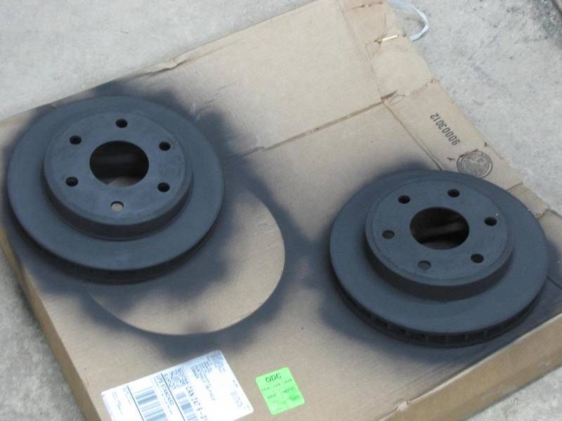

brakes
front end (every steering component)

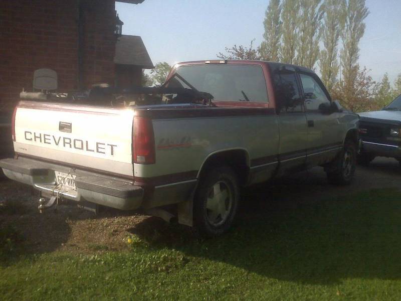

The truck is done now. I had the 2.5" true duals bent and welded in for me with my cats and mufflers. I decided to dump them just past the mufflers. I may add some resonators to the equation to get rid of the hollow sound, and frankly this truck is loud a hell right now. I am having some transmission issues that I posted looking for help on, but other than that she is ready for the road. Here are a couple pictures:

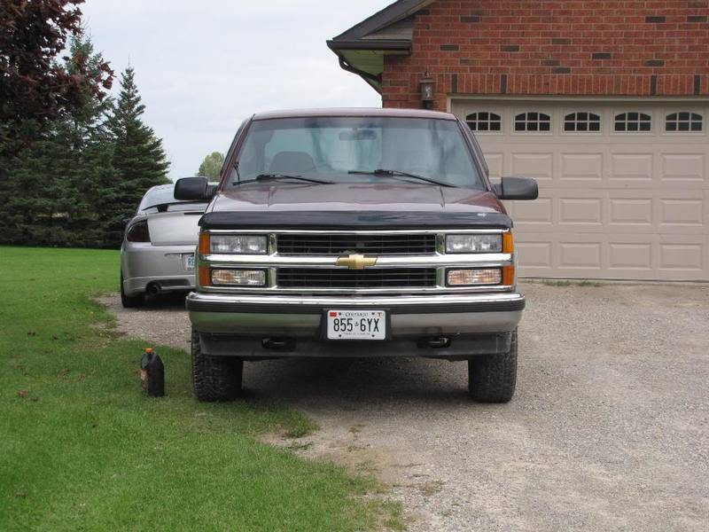

I got the heater blower motor/fan replaced and the heat works like a champ now. I also bought a set of tow mirrors like the new chev HDs. Man are they nice. I didnt opt for led side markers but got the power and heated versions. The view out these things is ridiculous. I have had to have the extended out yet, but im sure I wont be disappointed then either. I've also got the dual batteries in and my 10,000lb winch with snatch block. I also have a new center console with cup holders. The stock set up has the only cup holders right in front of a heater vent and I have literally burned myself on the rim of a can because of it. I bought my 6" lift kit, 16x9 wheels, and 35x12.50 mud tires and they should all be in by friday. I'm not sure when I'll install them, but they will be here ready to go.
now the pics:

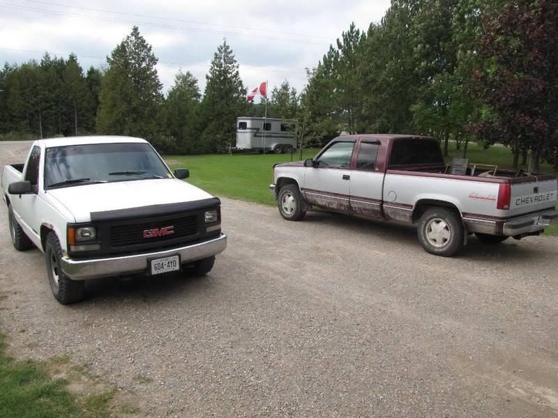

truck with new mirrors next to Sarah's for comparison purposes. She has the non power but same looking mirrors I had stock

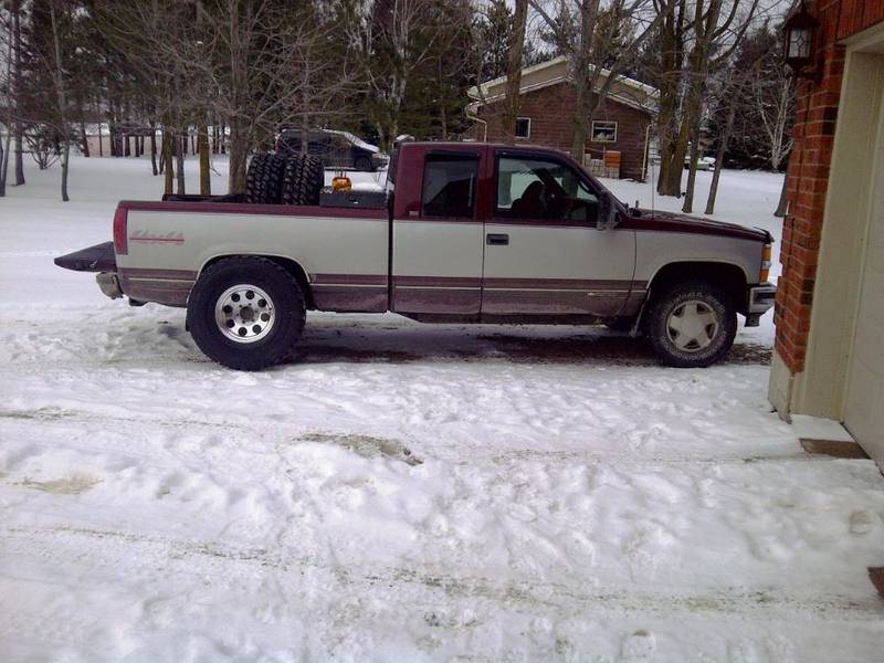

lift was supposed to come in today, and didnt. My wheels and tires are here and ready for install though

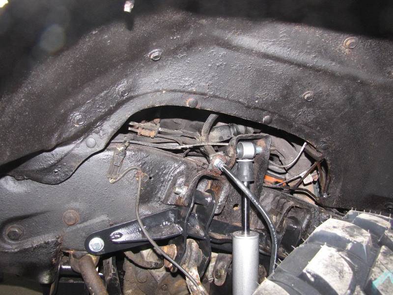

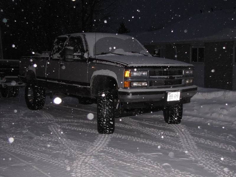

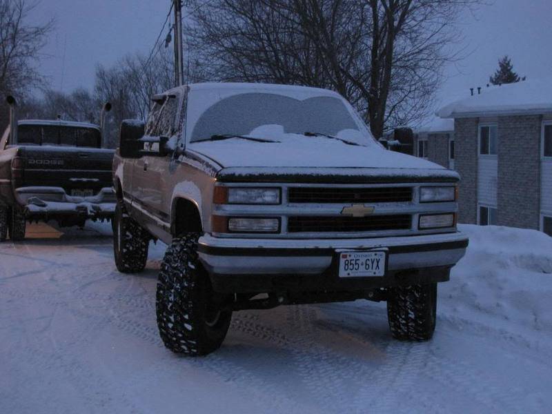

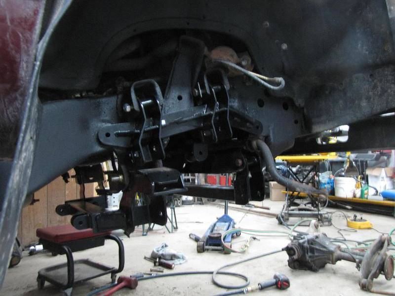

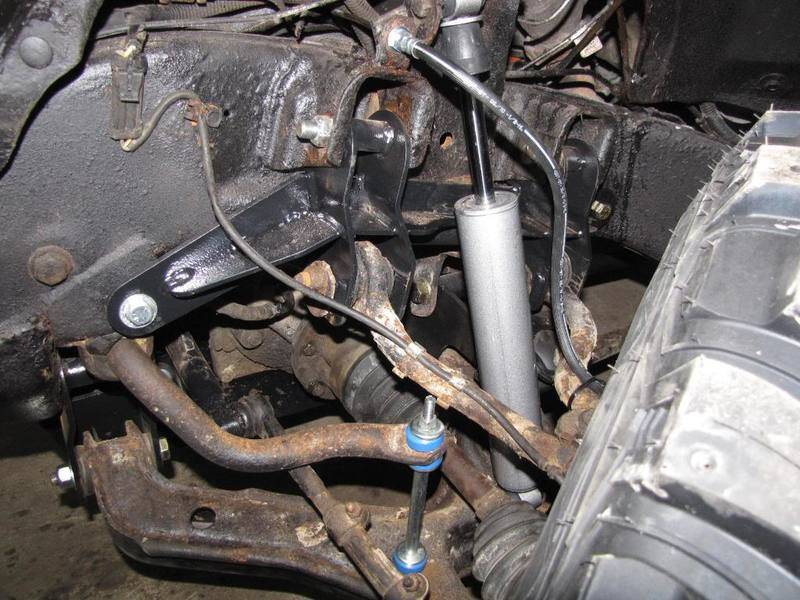

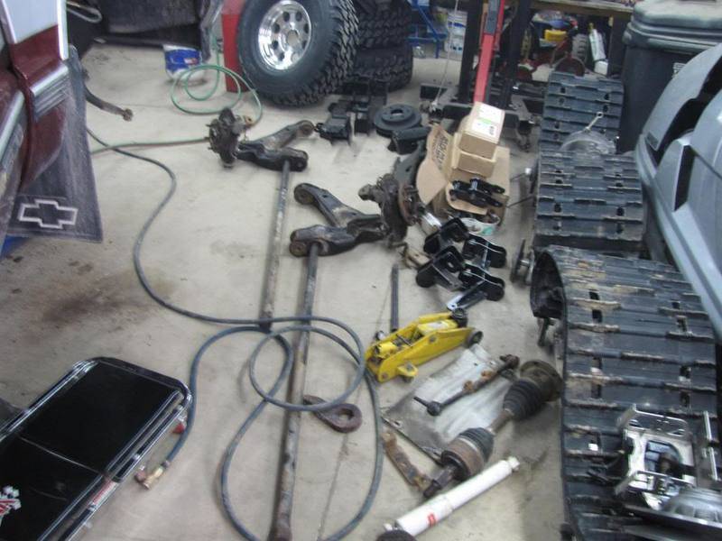

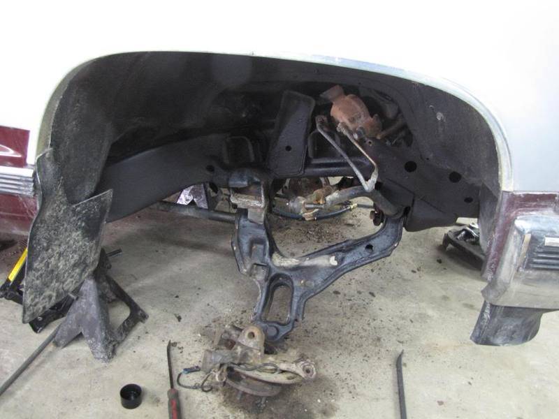

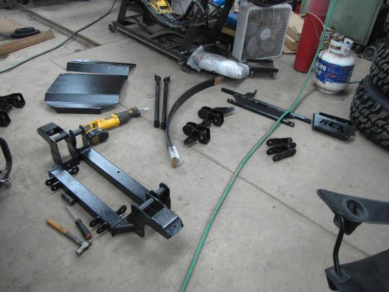

finally got the lift on RCX 6"
install
finished

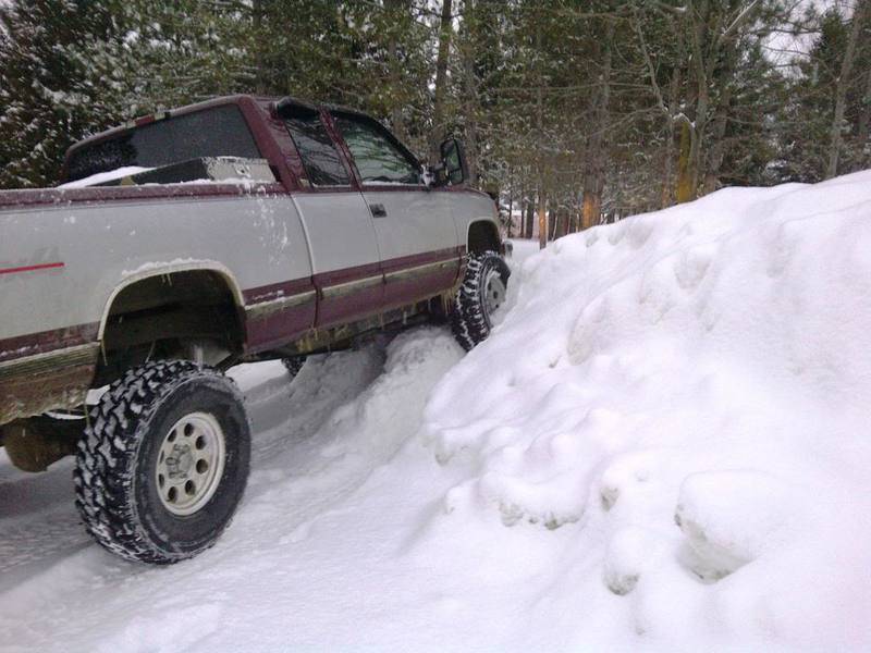

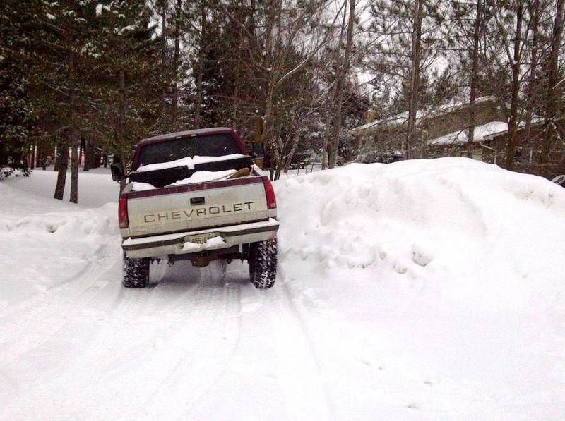

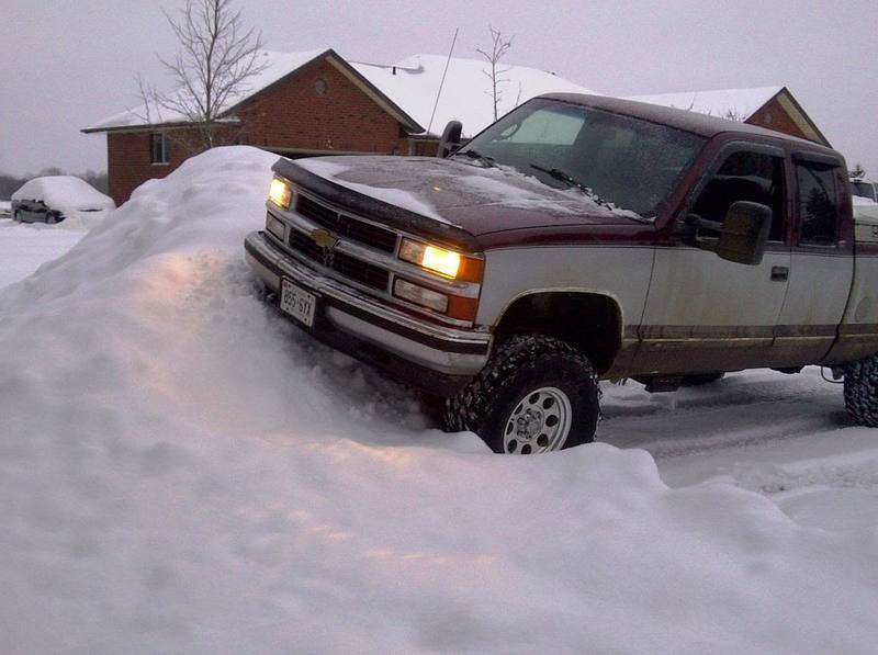

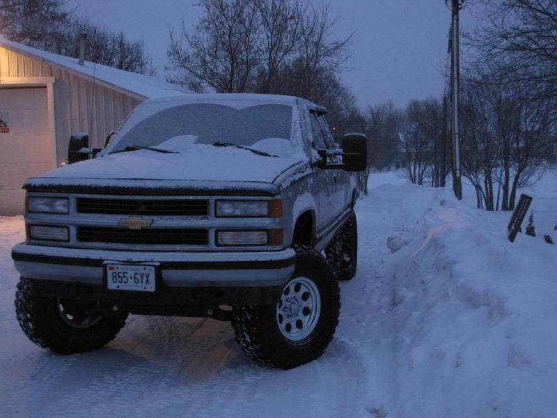

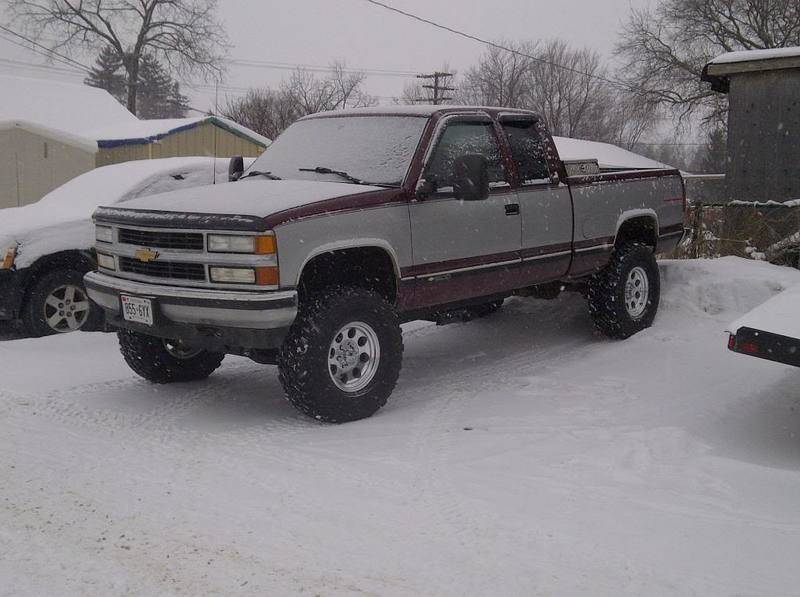

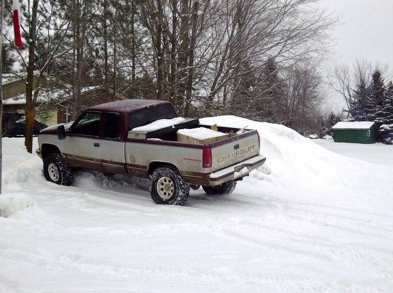

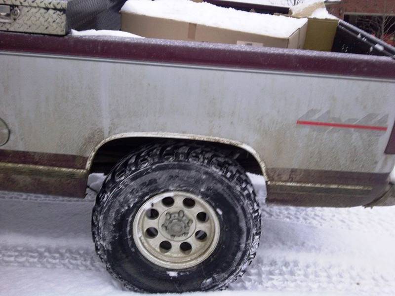

I was cleaning the driveway before the Mrs got home, and decided since i had to move the truck anyway.... why not smash into my snow bank and take pics. Turns out its pretty soft and steep so climbing it was out of the question. I know all you see is blah blah blah so here are the pics
