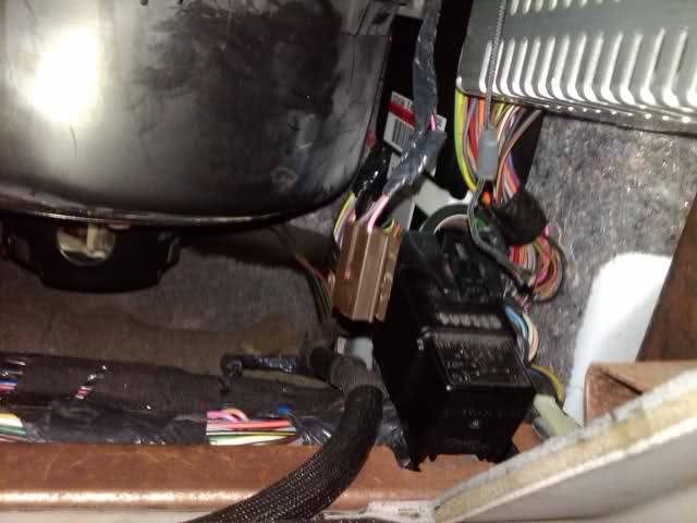

It is right behind the glove box, and I think it may be causing my CEL.
I looked everywhere and cannot find where this plugs into. Its pink and brown wires.
been years since I did it, but isnt that the connector that you bridge with a paper clip to program a remote?

WAIT!!!....This is his CE he's talking about...2nd gens don't have the connector for remote programming...it's done through the keypad

Hate to sound like a jackass but did you actually CHECK what CEL code you have?

yes. I has to do with a Vehicle speed sensor code. Im assuming its because I left something unplugged because I never had a CEL B4 the dash came out.
Oh yeah! That plug! You have to remove the dash to get to it.

I think I know. Is it for the light sensor on top of the dash. Auto dim.
If it is then yes, the dash has to come back out...... unless you have a wire snake.
