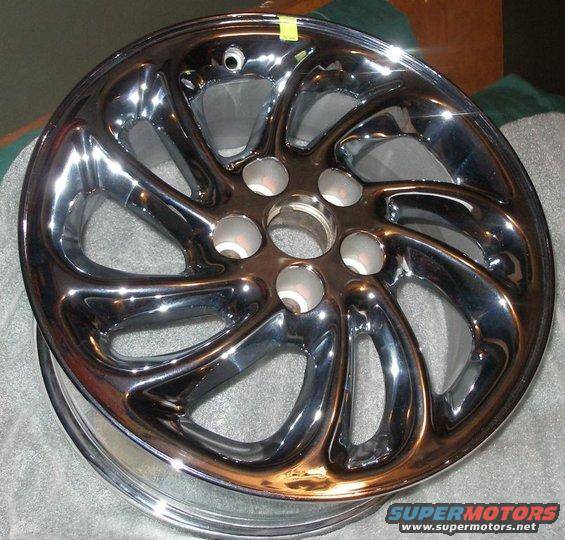

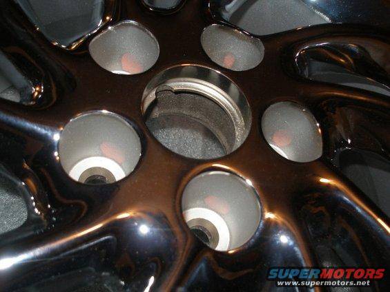

i'm gonna voice my opinion here and say if you want it to last, its better and cheaper but go with nickle instead of chrome. there is a slight difference in appearence, chrome is chrome, nickle is chrome looking with a slight slight hint of a bronze to it, side by side you could tell which is which, but once plated and on the car you'll never know chrome from nickle. i like nickle better but thats my opinion.
this is chrome plate:
and this is nickle plate:
First of all, it will probably cost you more to have chrome stripped, and re applied than a used set of wheels in excellent shape.
Second, Jamie, All wheels are chromed with use of nickel. If not, it wouldn't look like either picture above. Neither has a durability issue if taken care of. Otherwise both can have durability issue just about the same. "Chroming" is electroplating. The shiny is always nickel. Double chromed is usually one layer of electroplated copper, 2 coats nickel, one coat chrome.
The only chrome that will last through neglect is hard chroming, which generally only comes on things such as hydraulic cylinders, to withstand wear. Wheels are 'decorative' chrome, which comes in much thinner increments than 'hard' chroming, decorative chrome is measured in millionths of an inch. It's very thin. Appearance usually depends on thickness and how much nickel is underneath. Without nickel you wouldn't see chrome as being near as shiny.
Point being, nickel is not chrome, but what people know as chrome, is plating with nickel, then covering by plating with chrome.

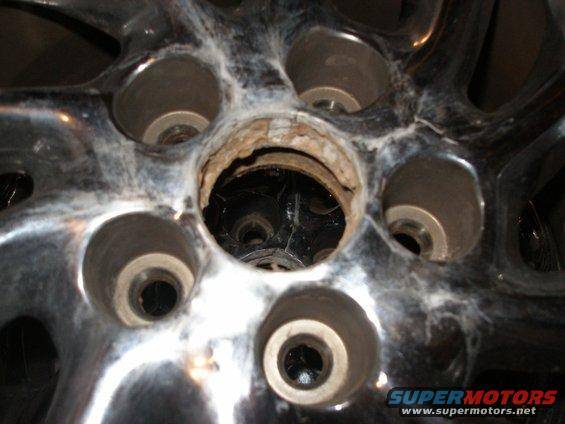

So thats what the hole for the centercap is supposed to look like. I thought my wheels were in good shape til I got new tires. When the tire shop removed the center caps for balancing, the chrome lifted. I do believe that water gets under the chrome right where it stops in the centercap hole. The fatal flaw for the chrome ten spoke.
