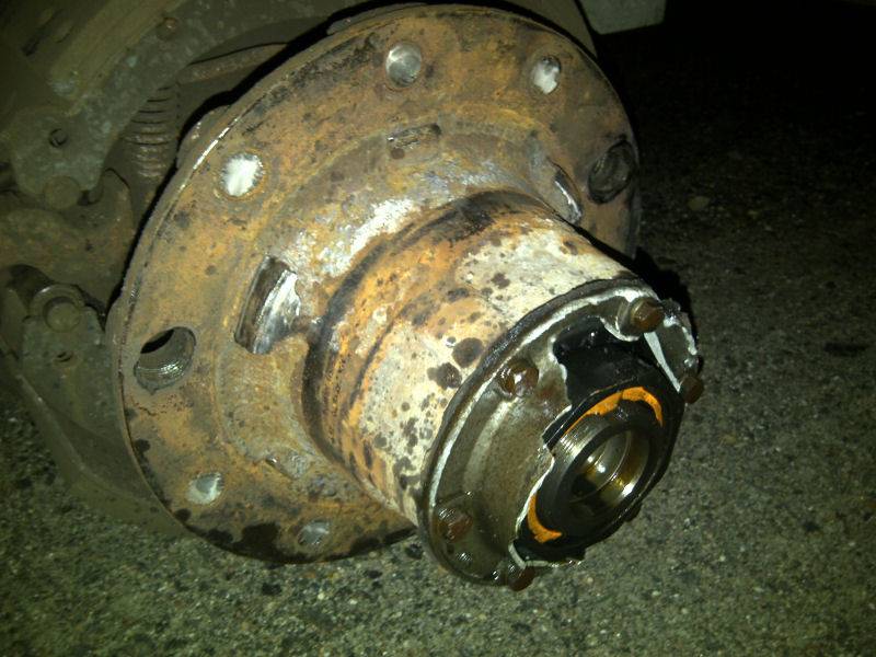

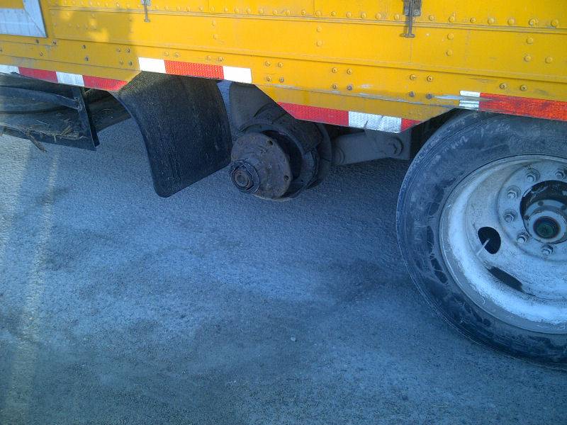

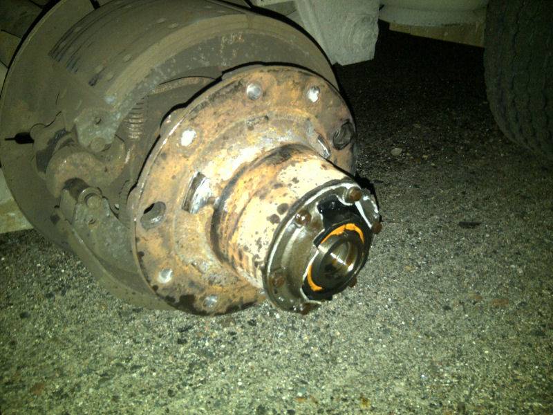

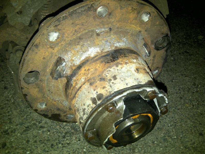

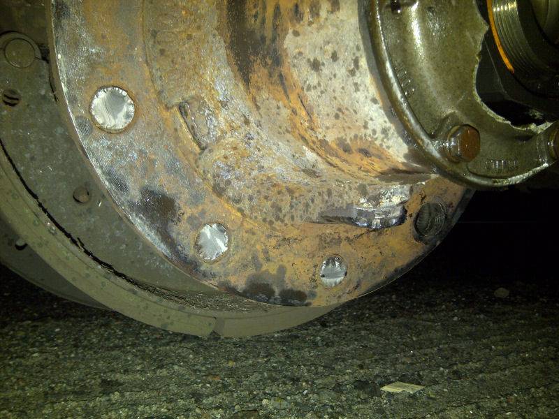

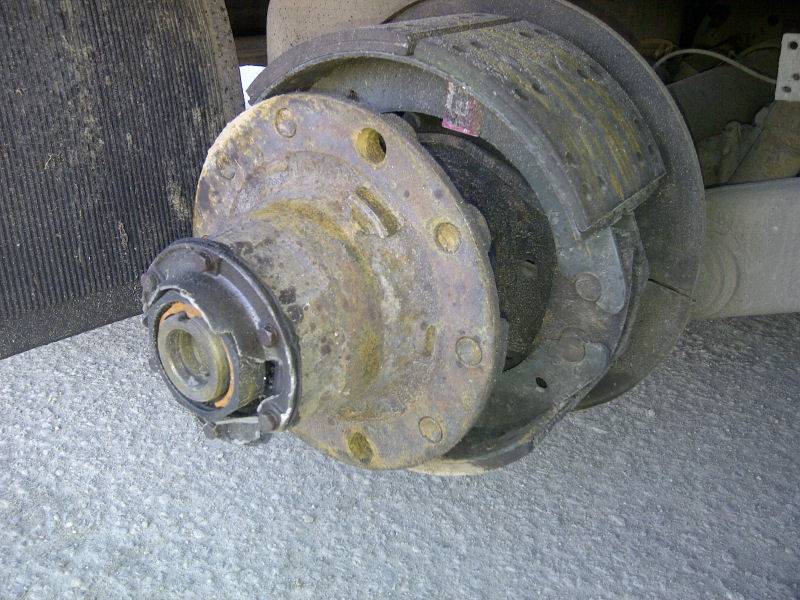

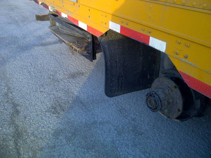

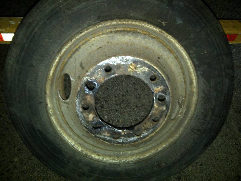

Question... Was it a company shop that did the work? If so, United is f@#ked either way. The shop would be responsible for "failure to provide safe and quality work". The van lines would be responsible for letting the shop release the trailer. I am sure Canadian DOT is going through your branches vehicle maintence records with a fine tooth comb. They are using a techincality to throw you under the bus on this one.
My personal experience and knowledge of torqueing down lugs on semis. If they under torque the lugs by 50lbs, the lugs work they way off or snaps. If they over torque the lugs by 50lbs, the lugs develop hairline cracks that results in the lug sheering off clean. I have seen and heard of shops tack welding studs in place on worpped hubs. There are a LOT of dumb@ss mechanics out there.:rolleyes:

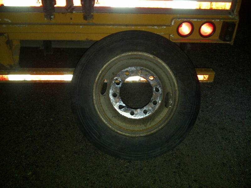

I'm with the other guys, I don't think a retorque would have saved those wheels.
I wonder if when a shop retorques them what they are supposed to do if they are way overtorqued?
I wonder if they checked the other wheels while putting that set back together?
I wonder how the freezing temps might have affected that wheel?

They are a United Member, it was a 2008 trailer, somehwat still in good shape but you and I know both that equipment goes none stop and gets worn down quickly. It was my own dedicated trailer this season. It was the first time this season that trailer went to that shop for maintance, I hauled it all season long without incident and they touch it for a day and 550Kms later, it blows up on me.
... knowledge of torqueing down lugs on semis. If they under torque the lugs by 50lbs, the lugs work they way off or snaps. If they over torque the lugs by 50lbs, the lugs develop hairline cracks that results in the lug sheering off clean .... There are a LOT of dumb@ss mechanics out there.
