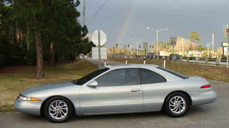

i have a lowered strumasters ultimate ride kit in my 93 that my wife wants out asap. she wants a standard kit in instead. she hits everything with the car i need to take it out asap. what kind of standard kit do you have, and how old is it? this is how my 93 sits.
