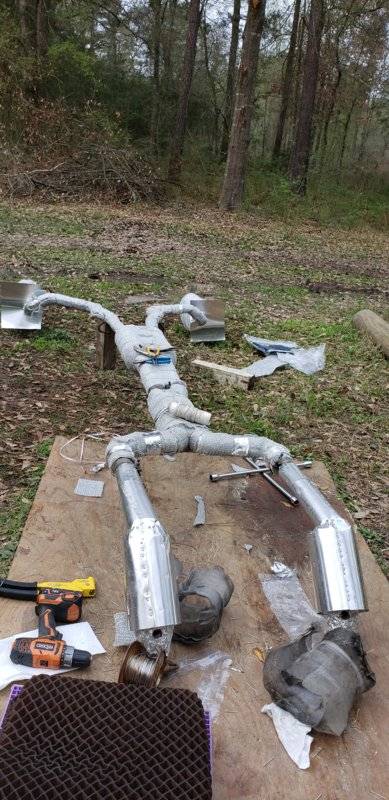

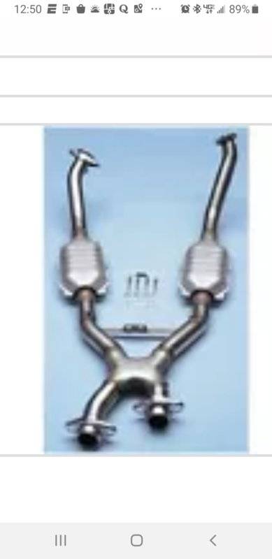

          Well I thought that too till I learned the Cobras had the factory install the Bassani X-pipe at 2.5 diameter piping. I had replaced the stock center chamber on my 04 LS Sport 3.9 with the X-pipe and covered the entire exhaust in Kaowool ceramic and fiberglass insulation with an aluminum skin to contain/protect. This one component replacement has made the most significant performance improvement that allow the mid-range power 2500-3000 rpm.to be realized. Acceleration is much improved also. The original system including the manifolds were wrapped in insulation and had a slight performance improvement but the end goal was to get the under body and engine bay heat under control. The carpet, shifter assembly seal, shifter cable plastic, drive shaft couplers, and other rubber items are affected by this intense heat 700-1100 °F. The exhaust manifolds covers were Kaowool lined and sealed with Permatex 650°F silicone on the exhaust steel gaskets The steel layer gasket were suspected of allow heat to deteriorate the valve cover gaskets. Other observations were the transmission shifting became a little more prompt hot as well as cold by not distorting the servo bores. An educated guess. I had replaced the trans in 17 with an Aamco lifetime with 20k service intervals. Excellent service at 75k on this one.

            What Cobra
          • SteveOwens
            SteveOwens LVC Member
            Messages:
            46
            Likes Received:
            4
            Joined:
            Jun 24, 2015
            Location:
            Magnolia
            Mustang Cobra late 90 into 2000's

            Here's some Bassani photos
