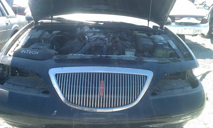

Anyway, what would they charge you for the grille and the "Intech" alternator cover pictured there?
Acoording to their website, the grill is about $21...not sure on the "Intech" cover, surely under $20 based on my experience.
It had an air dam too, I know people look for those. The air struts didn't look bad as far as I could tell, had some decent pieces inside (black interior).

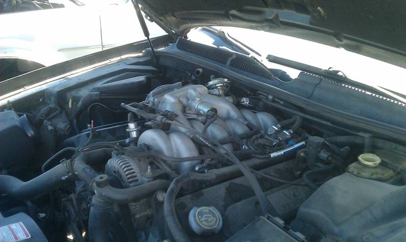

I think that may be a good engine. The intake looks real clean, and there's a Ford label on one of the hoses. I would be willing to bet that it is in the bone yard for something other than engine problems.
