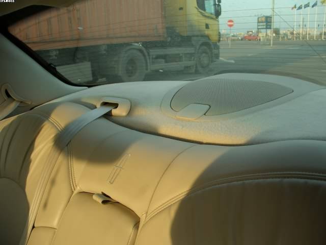

i have a 99 Conti and I have the Alpine line on it + the subwoofer , if is the one from the pics :)
Peel the cover in the trunk. Theres those 2 regular speaker sized Subs. Been in a 95, 97, 98, 2000,.. JBL Or Alpine I see the same set up and nothing but open air in that center vent. Heard a dude in some site with a pic like from above and said ( Under here lies a Factory JBL 8 inch Sub) on a 98 ( All Stock). I have a 98 with JBL and I don't see that, nor with any of the other above mentioned model years I've driven ( JBL or Alpine).
Tell me, Am I missing out on something here???????????????
I have the JBL in mine that center vent is just to let the heat from all the componets they have mounted on that tray. I thought it had a sub below it when we got the car till I dropped the tray and checked.
