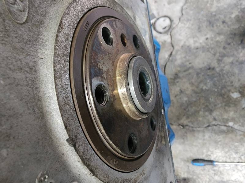

What pilot bearing for manual trans?
serfma
New LVC Member
Jul 26, 2022
Kentucky
I am swapping a 98 Mark 8 engine into my 96 Cobra and am trying to figure out what pilot bearing I need as the one for a 98 Mustang GT does not fit and as far as I am aware the 98 GT and 98 Mark 8 would use the same 6 bolt crank. As you can see in the pic it does not sit flush into the crank so I am concerned. Part # FC68329 is what I am using currently
