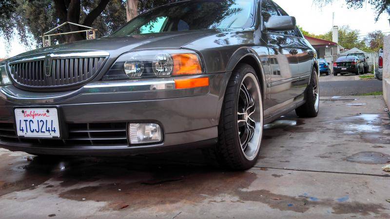

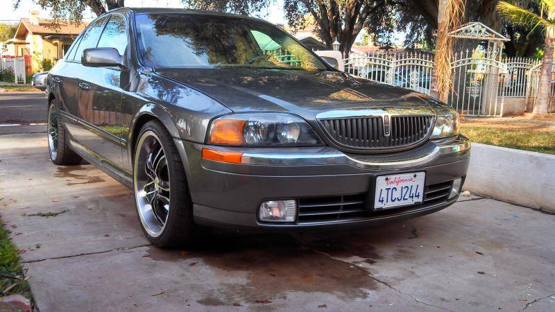

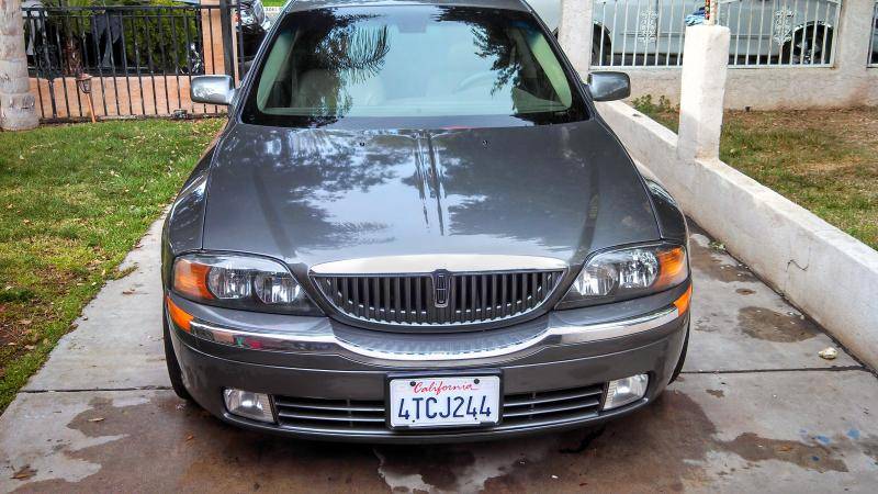

A few pics of my freshly waxed ls
Used me guitars 26 hi tech yellow wax
This stuff is great
