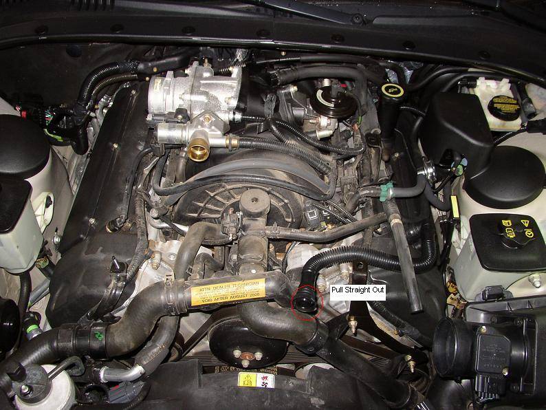

What is this hose circled? it goes from valve cover to air intake, mine was full of sludge and cracked, need a new one just not sure what to order.

It's the crankcase vent tube/hose.

Its the coils and plugs causing the idle and rough running. The crankcase ventilation system is just a way for gases to escape in a controlled manner from the crankcase of an internal combustion engine. I dont know how you got so much sludge in the hose.. Do any of the intake parts have the same sludge?
What kind of sludge? A whiteish or grayish sludge is usually normal in crankcase vents and is simply moisture.
yes - it is normal for 'some' oil to collect as part of the venting. it happens in higher compression cars more, and in forced-induction even more.

1. Some crud in that tube is normal. An excessive amount would be caused by excessive blow-by. Excessive blow-by is caused be worn rings. Here's a simple and non-precise test for excessive blow-by. With the engine running, remove the oil fill cap. Put your hand over it. If you feel a slight suction, then all is well. If you feel continuous puffs of air coming out, then there is a problem.
2. No, sludge in the crankcase vent is not causing your rough running and idle.

Okay, so I assume that you plug the hose back in and place the clamp correctly. Which hose is it exactly? If it where one of the two radiator hoses , you'd lose just about all of the coolant at once. Is it one of the smaller hoses? At which point is it popping off? Sometimes the plastic nipples break off leaving enough sticking up to put the hose on, but without the barb at the end to keep the hose from sliding off.
Coolant degrades the accessory belt, so you may need to replace it soon. If any coolant gets inside either coil cover, it will destroy the coils. If any coolant gets into the crankcase, it could explain the sludge.
in the picture above it is the hose just to the left of the yellow sticker, that clamp keeps coming loose, right after that happened yesterday it started running rough.
Okay, so it is the top radiator hose. I would suspect then that you need to replace the top plastic part it attaches to.

Get a worm gear style hose clamp (or Two) and get rid of that spring one.
i think your talking about one that tightens with a screw? thats what i have now. i will pull the codes tomorrow and post them. thanks everyone! im a newbie looking to learn and save some money!
It's a spring clamp in the picture. Did you change it to worm gear clamp after the hose popped off the first time? Could you post a picture of the end of the pipe with the hose off?
