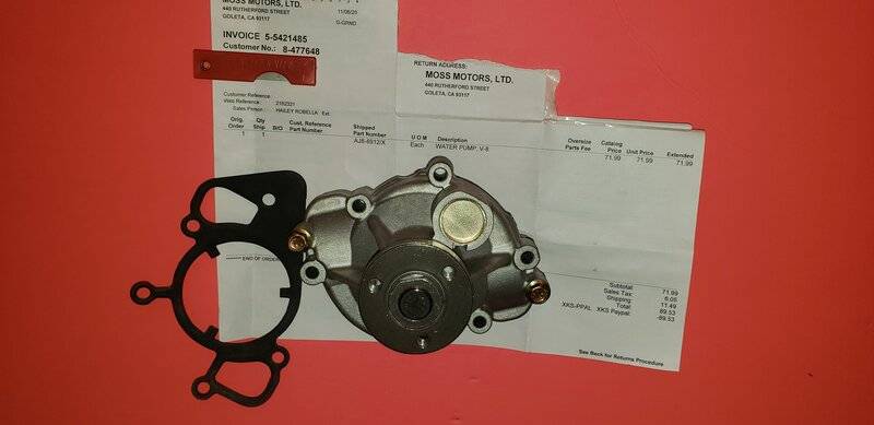

I found this water pump with an aluminum impeller for the AJV8 at Moss Motors.
