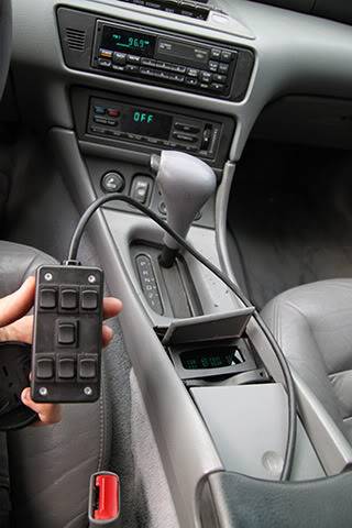

Seen this kit and it just caught my eye...I guess if one was really serious more details would defiently be ironed out before purchase

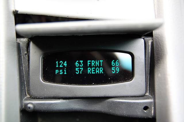

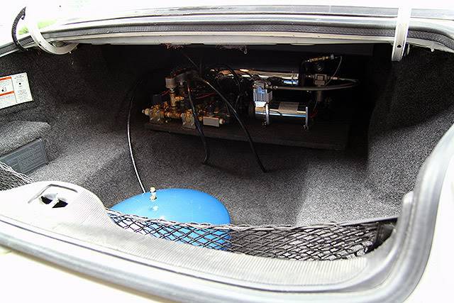

stay far away from that ****ty kit. airbagit.com has the worst products and horrable customer service. i peiced mine together getting the parts i wanted and idont have more than 800 in all of my air ride. now the fab side if you have done alot of it like i have its easy otherwise its not going to be much fun for you. some of you mentioned that you dont think it would be any more reliable than the factory air ride, whys that? i installed mine a year and a half ago anf havent touched it since. then some said the handleing would suck, also why? with it being to where you can adjust every aspect of the spring rate and height your handleing will be better as you can set it to where it needs to be to cut corners or ride like its on rails. then some said well how do you know what height your at? we easy you can ether install guages then set the height you want and get out and look at it and remember that air pressure or like me you dont run gauges and you just get a feel for it then after a bit you know the exact height you are from in the car. alot of people have bad opinions on air ride but that fact is they dont know **** about a good quality job because all they have seen are ****ty hack jobs.

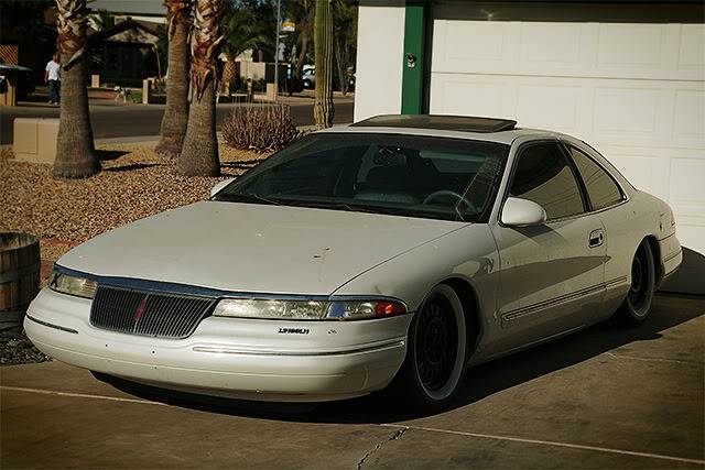

this was my beater car for a while, I made it a point to never wash the outside
That's awesome...what did you use in the front?
That's the kind of control I'd like to have if I was to keep air ride
Others have used bags like the rears in the fronts...not sure on how they were mounted.
ive personally only seen one oter done with a double convoulted bag in the front and it used a big bag cup like you would in the rear. this white car im assuming as it dosent lay out is on all the stock bags just with valves added in. mine is on dominator 2500 pound bags in the rear and modifiyed to lay out flat stock fronts with the vlaves and all that added to it
