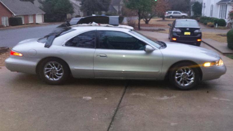

Got home in time to back the car out of the garage and snap a couple pics. My driveway is a bit sloped so the pic is just a little misleading but look at that tuck! Lol

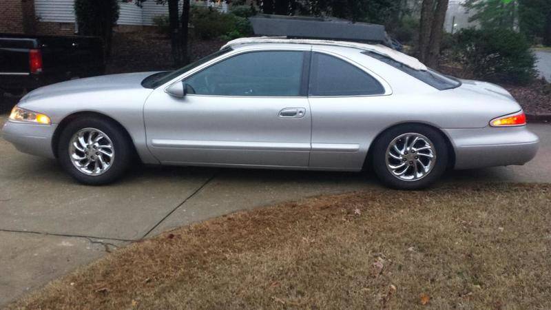

The other side
I think you'll be fine with the cobra isolators. They add a lot of ride height. It should level the car right out. New shocks and shock mounts will most likely help add a little height too. Once the back of the car goes up the car will level out.
You don't want to cut the front. The shocks that are available for these cars is limited. The lower you make the car, the weaker the shocks perform. The cheap shocks will feel like they need to be replaced right out of the box with these springs. You need a strong shock to dampen these springs. Otherwise it's going to bounce and float a lot. What are you running for shocks anyway?
