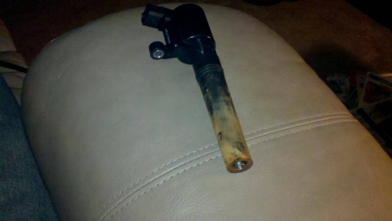

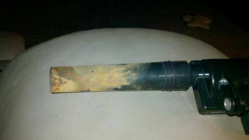

ok so i pulled out the cop again today and replaced it with another old one and i also replaced the cover that goes over them, and when i pulled it out it looked like this and it smells like it was on fire:
That's just the misfires because the coil finds the path of least resistance and fires to everything except through the spark plug. Most of the upper parts of my spark plugs are showing severe evidence of sparking, corroded. The spring interface between the spark plug and COP isnt' engaging enough, it needs hard COP shafts with a mechanical interface-click onto the spark plug instead of a spring.
