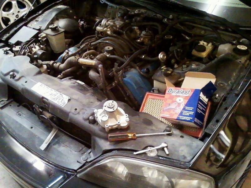

I can not believe the problems I'm having with the LS here lately!!!
I get out of work and there is a puddle of water under the bumper. I start the car and it sounds like a can of marbles being shook sort of. Well, I got home after filling up with water and find that the water is leaking from the shaft on the pump. I was able to get another pump from autozone, the Duralast brand. I'm nervous to drive this thing anymore. :shifty:

It's actually not a Lincoln problem. I forgot to mention I replaced the waterpump about 2 1/2 years ago, but I can't remember the brand, not Duralast though. Just everything here screwing up lately Lincoln or not is getting really old. :p
Crazy. I was still on my original water pump at 207,000 miles. Original alternator as well. Hope things settle down for you.
Yeah, hopefully. It's fixed and back on the road now.
I will say that the water pump on the LS is got to be the easiest to change. Remove the intake tube and the belt, the three 8mm bolts on the pulley and then the 5 8mm bolts on the pump and it's out. Took about 35-40 minutes to change. No water hoses or anything else to remove.
