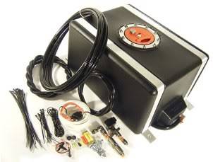

Below are two Methanol injection systems for the Lincoln Mark VIII.
This one is an adjustable boost activated system.
Easy 60-90 minute installation time.
250psi pump and injectors.
Long tubes for convenient trunk mounting.
Pre-wired and tested from Robs Tire and Auto.

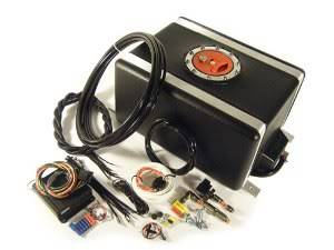

This one is for carburated or forced induction engines.
Digital progressive controlled.
Advanced tune boost activated system.
Features for the average driver to the most serious racer.
Easy to install. Trunk mount.
All hardware included.

Fairly useless untill you have forced induction. The cost of the kit plus the expense of a dyno tune for a 2hp gain is not worth it. With a blower/turbo it makes a significant difference because you can add more boost and timing to maximize power but on a stockish NA motor its not gonna help you. That 2hp gain will be lost by the weight of the tank alone.
That is the Meth injection system I have in mine. Love it. Looks like a mini fuel cell. Great for forced induction. I got mine from Rob or RobertP also.

Lasers close to right - now if you could only get 87 octane the w/meth injection might do some good but being you can get 93 or so it don't help all that much in a n/a motor - the water/methanol injection does really good at preventing detonation so you can crowd the timing - you get the most power out of an engine right before detonation. that's why e/85 does so well with a power adder.
I'd give it 10 to 12 hp using w/m injection but you need to change the timing and fuel map to make it work - getting kinda on the edge scary - especially if you don't have forged pistons,
Throw the pressure to it - throw the timing to it - throw the fuel and a hot spark to it and make big power numbers - just got to keep it cool enough to not pre-detonate :D
It gets to a point where more timing is not going to give you more horsepower. Right around 30 degrees at WOT which you can safely run on 91-93 octane.
