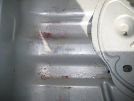

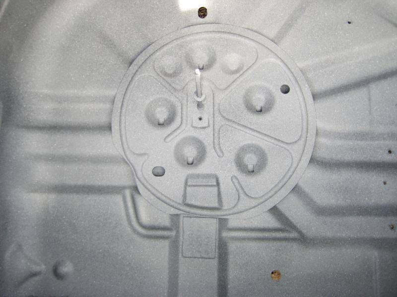

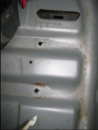

I will probably silicone all the bolt holes and check tailights again, but the trunk is not looking too pretty anymore, so im considering painting it. Im still pondering which products to use. Maybe bedliner with silver over it? or rubberized undercoating? any suggestions would be helpful.
here are the pics

I plan on painting just to keep any rust from getting worse. You don't see that area normally so aesthetically I'm not worried about it.
