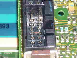

OK Took pink eraser to all ribbon connectors and "big" plud as per "DCL Tuneup" instructions.

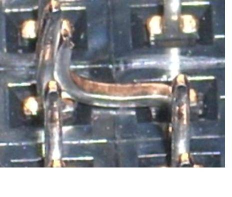

HOWEVER - one of the prongs within the larger black connector on the breadboard is bent (see photo). Is this SUPPOSED to be that way or should I straighten it ???
ALSO - not sure what is supposed to be re-soldered since all connections are solid on breadboard (especially paid attention to those of the black connectors).
breadboard, not Printed Circuit board?? could you take a pic of it from a little farther back?? I want to make sure we are looking in the same area.
The particular prong that is bent is once again within the LARGE black connector and looking at second pic .... amongst the RIGHT side set of prongs - the fourth from the top (per second pic). Referring to the very first pic I submitted, you can see that the bent prong would connect to the plug right along with the corresponding LEFT hand prong. This looks strange to me at the very least.
I think I'm confusing matters trying to explain.... I think you can get it.
Should I straighten?
yup.. bent pin, thats for sure, they should all be straight.
also, the resoldering is on the backside of the board them connectors are mounted on. you need to resolder the locations where the pins connect to the PCB. you will need to disassemble the cluster to remove the board. be carefull doing it, as these are old parts we are working with, and a lot of the plastic is brittle.

make sure to straighten that pin carefully. dont want to break it off. that connector will be a biatch to find a replacement for, except from a doner cluster.
