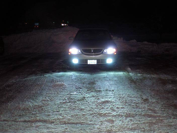

Maybe the headlight eyebrows help? I honestly don't think there is a huge amount of glare, but agree 100% that projectors would light up the road a hell of a lot better than the retrofits I have in there now:
Do they glare? Yes. Terribly? I don't think so...
