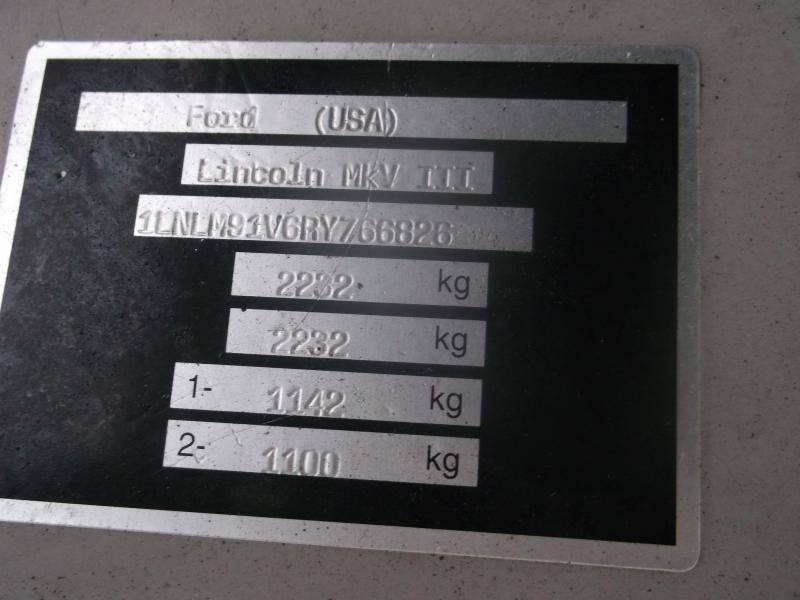

Where are the VINs located in a 1995 Mark VIII LSC? I know one location is the sticker on the drivers side door jamb and another one is under the windshield. But shouldn't there be one stamped into the body as well? I know my '94 had a metal plate in the engine bay bolted to the drivers side fender but its not there on my '95, and it wasnt exactly stamped into the body either.

I was surprised my '94 had a metal plate with the VIN on in the engine bay and my '95 didn't. I guess thats normal, too? Or was that plate added after the car left the factory?
Added after the fact.
