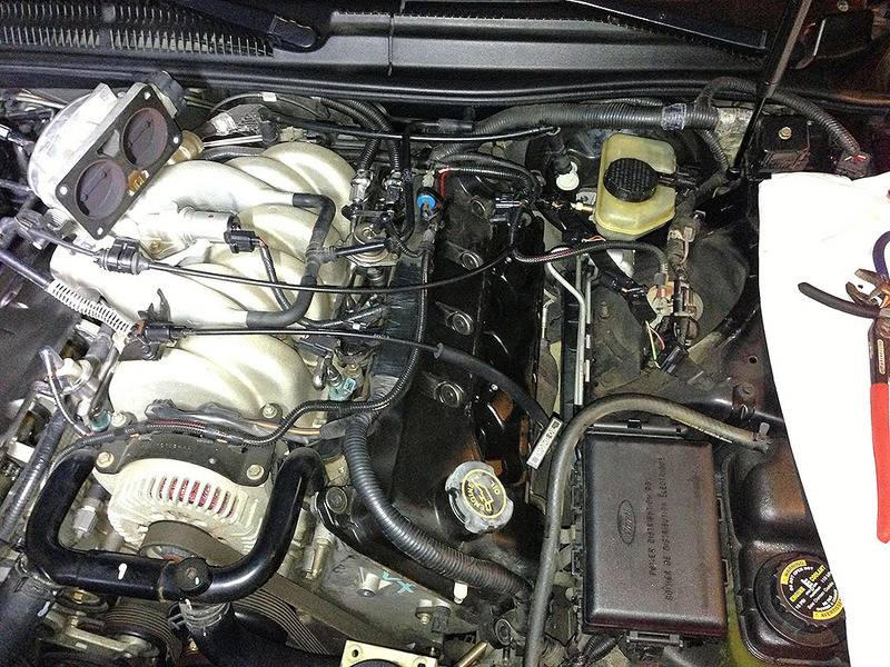

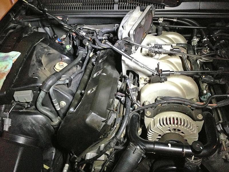

On the driver's side, the book recommends removing the wiper motor assembly, which I didn't do. It also recommends removing the fuel injector connections and wiring harness which I partially did. The two connectors and post push-on type are right underneath the fuel lines and a real nuisance to get to. So I loosened the front two. Brake master cylinder is loose, power steering fluid reservoir and bracket and all the sensors above and next to the cover. I'm really close, but the remaining fuel injector connectors seem to be screwing me.
With the passenger side, it was super easy to get to, but the heater hose seems to be preventing me from lifting it up enough to extract.

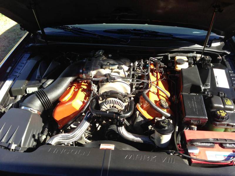

Well, here we go, boys and girls. The 98 came home today with some pretty gorgeous new metallic orange with gold flake valve covers, braided hoses with black anodized fittings, new Motorcraft ignition coils on the NGK Laser Iridium plugs I installed a couple of weeks ago, and a new Gatorback s-belt. She's got the serious purr going on now. :p :D Go Giants!!! Oh ya, and the plug on the crossover tube didn't play nice, but my mechanic was able to coax it off. Shew, cause there were no replacements to be found around here. :shifty: I'm going to send Ford a nasty, real letter about discontinuing our parts, even though I know it won't help. It will make me feel better. :)
