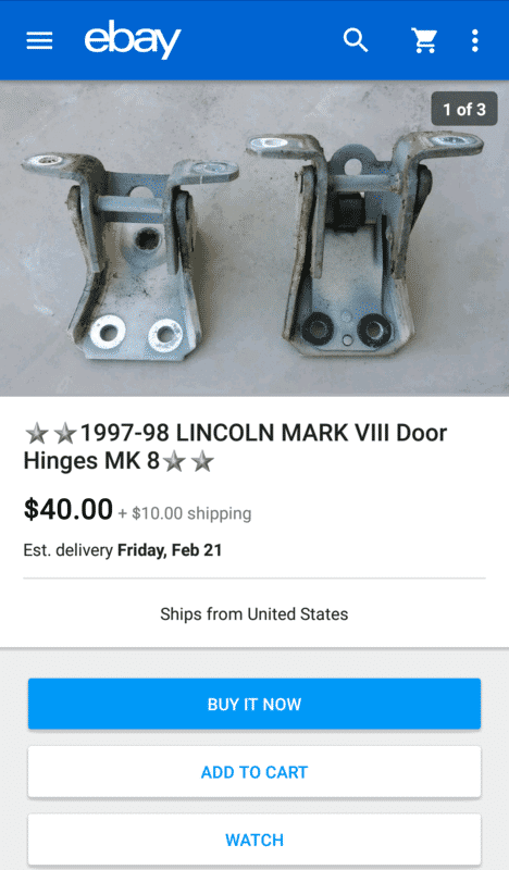

Found these just now. Maybe not the side you need though.
Found these just now. Maybe not the side you need though.View attachment 828573616
Thanks I saw them too. Just wonder if they are worth it. My research has found that they (driver& passenger) are interchangeable. Also that most body shops carry the pins and can do this for $40 or so I read anyway. For the pain it appears these are to do, I was thinking instead of buying used to buy new and go to a couple of body shops for quotes. That way it will be properly aligned too. Thanks though, I appreciate it just the same
