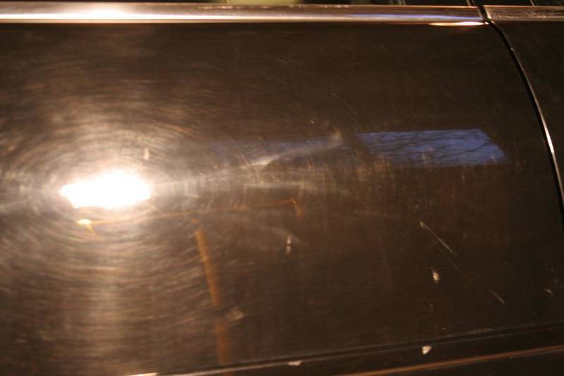

Water doesn't bead off my paint... It needs to be corrected badly.
Not yet. All I've done since I bought the car is wash it and hand wax. Light machine wax but it's never been wetsanded or clay barred.
I need to try and get some close up pics so you can see how bad the swirls are.

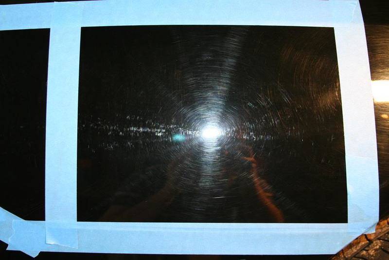

I'm sure they aren't great. Did you see the before pictures of that impala SS I detailed?
TEst area before:
And after one hit with a compound and wool pad:
50/50. Can you tell which side got polished?
After polishing, before wax:
In order for water to bead up and fall off the surface nicely, you need to claybar. That will remove embedded contaminants, and make your paint ultra smooth. Claying the car also helps the longevity of whatever sealant/wax you apply.
