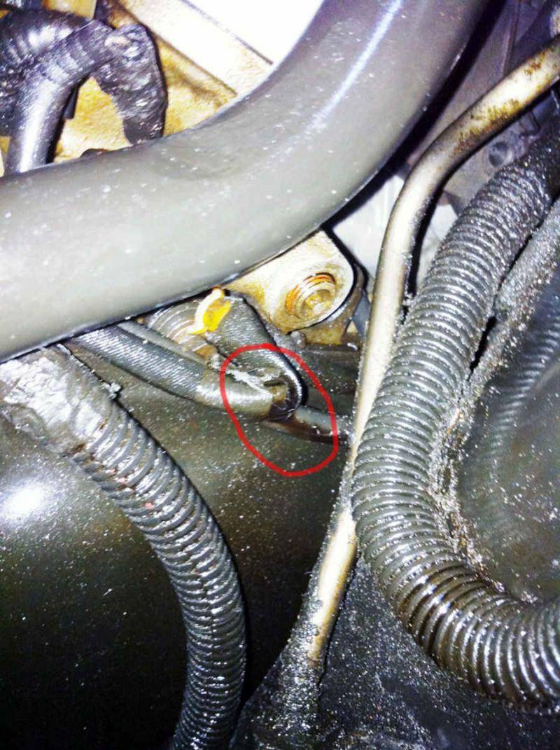

Hi guys,
1) I couple weeks ago I did an oil change. While under there, I checked the obvious place the massive leak would come from, but the surrounding area around the filter adapter is bone dry.
2) Since these cars use electric oil sending units, oil doesn't appear to be coming out of that either (remained dry even after wiping it down).
3) I can't really tell if it would be coming out of the oil dipstick area, because #4 below adds to the mystery.
4) Oil is coming from within this wire loom, but I don't know what the source is. What's inside this loom that could possibly carry oil? See pic:
Any ideas?

Do you ever smell or notice smoke from excess burning oil coming out from under the hood after setting for a day or an all night setting?
Thats the oil level sensor wire.
I bet your OPSU is leaking, they leak BAD when the epoxy at the connector goes bad. Then that oil blows everywhere.
Replace the OPSU, use thread sealant (not thread locker) on the end that goes into the filter housing, spray area with brake cleaner and wipe. Check oil level

I don't really have a concrete answer, I Just know that the oil that is splattered allover the driver side cat burns off. I have to leave the window cracked during driving so the smoke doesn't build up in the cabin.
Wow, that's just weird. Maybe I should have disconnected that switch while I was under the car waiting for the leak to come out of somewhere other than the wire loom. So you're saying it could be coming out between the black part and connector terminal?

Yeah dude, when that black area leaks.. its like you left the drain plug half open... it leaks BAD
In your pic you see they place red sealant on the threads already, DONT trust it, wrap those threads up with plumbers Teflon tape in the opposite direction as the threads. I wrap mine to where its pretty snug going back in, like 5 or 6 full wraps
Remove your OPSUs wire, and see if that connector has ANY wiggle, there should be NONE
Keep in mind its the oPsu... needs pressure, so the leak will only show with engine running
