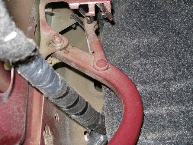

I will try to locate this bolt, but im not experienced when it comes to cars at all lol, so I snapped some pics of the trunk mechanism: 1 and 2. Is it in there, or even deeper?

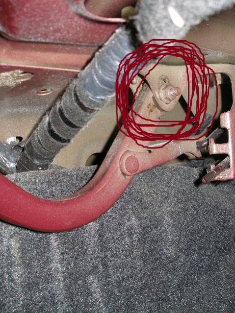

I believe it's where the back of the hinge mounts. It should be visible with the trim piece removed. I'll try and get a picture; hold on.........
Here you go. The bolt is circled.....
GRRRRRR. let me try the picture again......
I must be blind.. I see a bolt but no circles :confused:
Edit: that's probably gotta be it. So am i meant to change the position of the arm, and move it all the way to the bottom (on both sides of course)?
Okay okay, that works :p Forgive my amateurism, thank a lot!
Yes and no. You have to experiment with it. Move the hinge up/down a little at a time. Both sides should be about the same.

Yay, i fixed it!
I noticed that the right side of the trunk was sagging a bit, misaligned by about ~5mm compared with the top of the quarter panel. So i loosened the nut, as suggested by LS4me, moved the whole arm up, and the trunk no longer flies open :D
