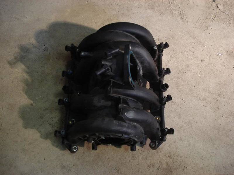

this is your intake manifold:

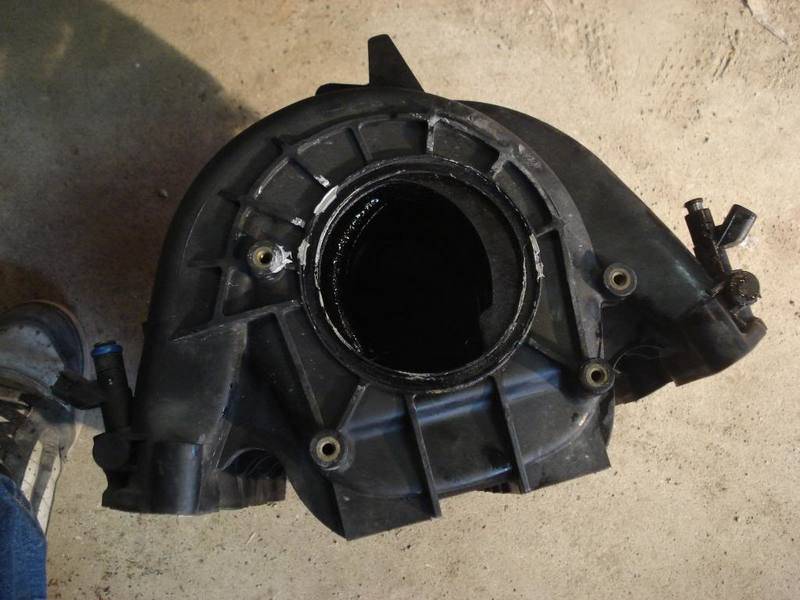

this is your intake manifold on Nitrous:
any questions?
Where's the frying pan? :p
Looks a bit sludgy in there. I think id give that thing a good scrubbing with a bottle brush before I put it back on my car.
Did you find the piece that blew off?
