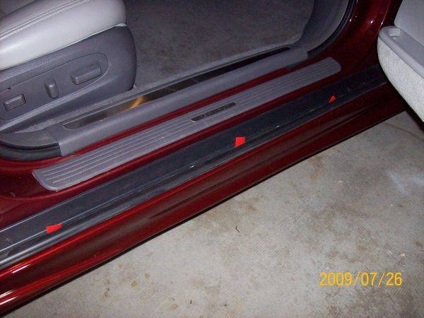

Hey RollinLS, Im doing my first kit myself this wekend. I got 01 LS Midnight Blue, beautiful car. I saw I purchased the same Razzi Kit you have on your LS. Quick question do the rocker panels stay on, or do i take them off when the kit goes on ? Would appreciate some Info , Thanks
The rockers stay on. The side skirts mount over them. You will need some self tapping screws and 3M double side tape. The rear splash gaurds will have to be removed too.

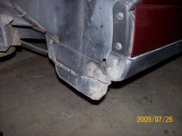

Third picture is the splash gaurd that needs to be removed.

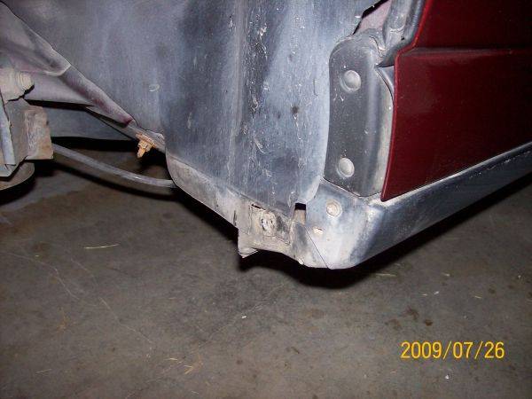

Fourth picture spalsh guard removed in the rear wheel well.

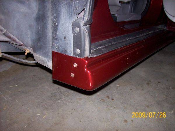

Fifth picture is the side skirt mounted in the rear wheel well.

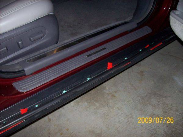

Sixth picture is the rocker with the rubber seal pulled out. The red tape is the 3M tape dog earred.
Sventh picture is the side skirt in place. Notice the red tabs. That is the 3M tape dog earred. All you have to do is pull the red tabs. The 3M tape will be exposed. Just press down for the tape to stick to the side skirt. You will need patience and a small flathead screw driver to get the plastic pens to the rubber seal back in place. DONE!!!!
