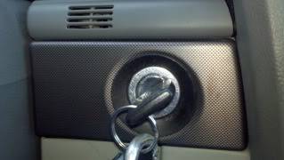

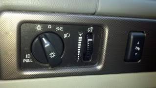

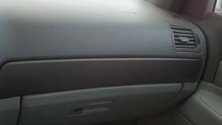

How do you remove these trim pieces. Do not want to break them.
dont know if all the yrs are the same for this but i have an 01 ls bottom 2 pics just pop off take a flat head carful to not scratch and as for the first pic it pops out but has a lip on the bottom part so it might be eaiser for you to pry the panle by the driver side vent off just a lil bit hope this helps
Open up the glovebox and gently, but firmly, pull straight out from the corner. I pull from the space between the steering column and trim piece for the small ones.
